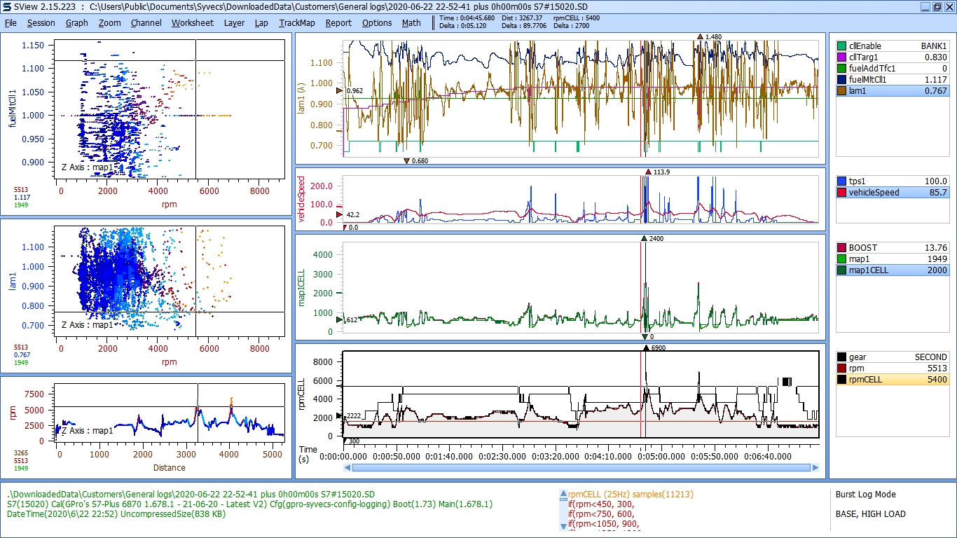

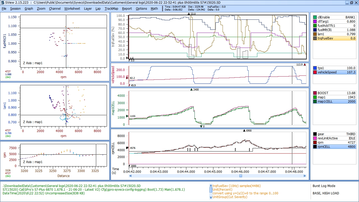

I am in the middle of tuning my new Syvecs S7 Plus and noticed the ECU is targeting a higher boost pressure then I originally set. I wanted 1bar of boost in cal 1, can someone take a look to see if I have missed something that could be adding boost?
What I have is 2600KPA in my wastegate maximum pressure target table, but using a -600 wastegate map target adjuster for cal 1 which should be 2000 KPA = 1 bar of boost but in my logs it was targeting 2420 which is odd.

You have some lean AFR at WOT. You may want to fix this first.

Also its bad practise to start stressing the engine without the base fuel being in the right direction (fuelMltCll1 <= 1.000), you want to be rich of your target not the other way as when limiters of any sort are applied the ECU correction is off and then its down to how good you set it up, not how good the cll control is.

Fueling on WOT is near perfect with under 3% adjustments from closed loop lambda, the small WOT pulls on this log is from a much colder night then when it was originally mapped so I am adjusting my air charge temp multiplier to get it fueling spot on again. And as for running very lean on WOT, keep an eye out when TC engages. As it naturally lean spikes.
So to answer my own question Callibration switch target needs to be set to Maximum target, not target limit?

^ I'm not talking about lambda spikes when fuel is cutGpro wrote: Tue Jun 23, 2020 9:34 am Fueling on WOT is near perfect with under 3% adjustments from closed loop lambda, the small WOT pulls on this log is from a much colder night then when it was originally mapped so I am adjusting my air charge temp multiplier to get it fueling spot on again. And as for running very lean on WOT, keep an eye out when TC engages. As it naturally lean spikes.
And yes is your answer to other question as per help video which explains it very well.
