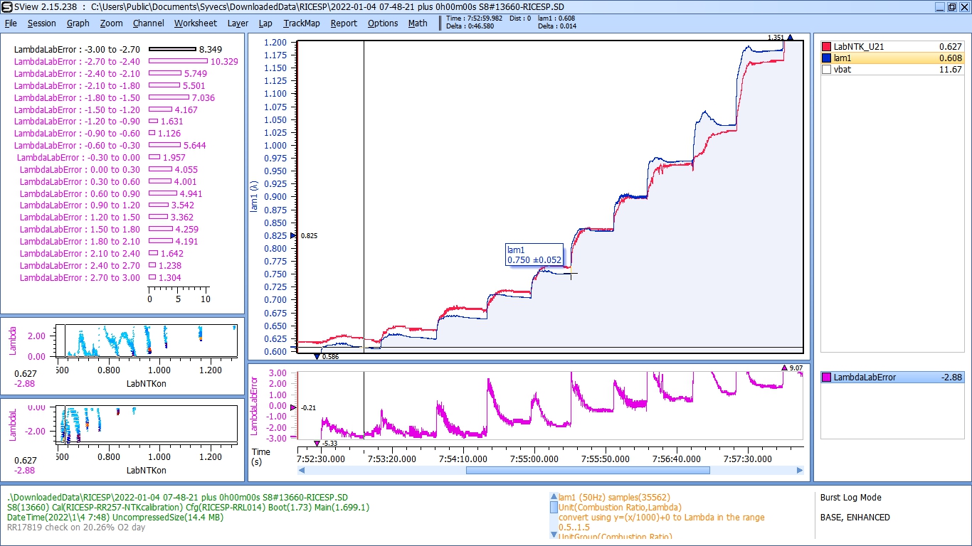

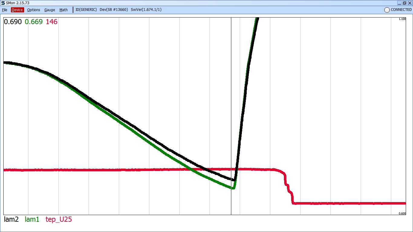

I finally had a chance to compare my LZA09 (S6 using the syvecs supplied LZA09 calibration) with a LSU4.2 (VEMS controller) as well as the motorsport grade NTK sensor running off an F88 (as supplied by Life Racing). From lambda 0.70 to 1.15 all three sensors read identically, going in 0.05 increments. Only at lambda 1.2 did the LSU4.2 show 1.29, whereas my Syvecs and the LR F88 both agreed on 1.2
Your mileage may vary.

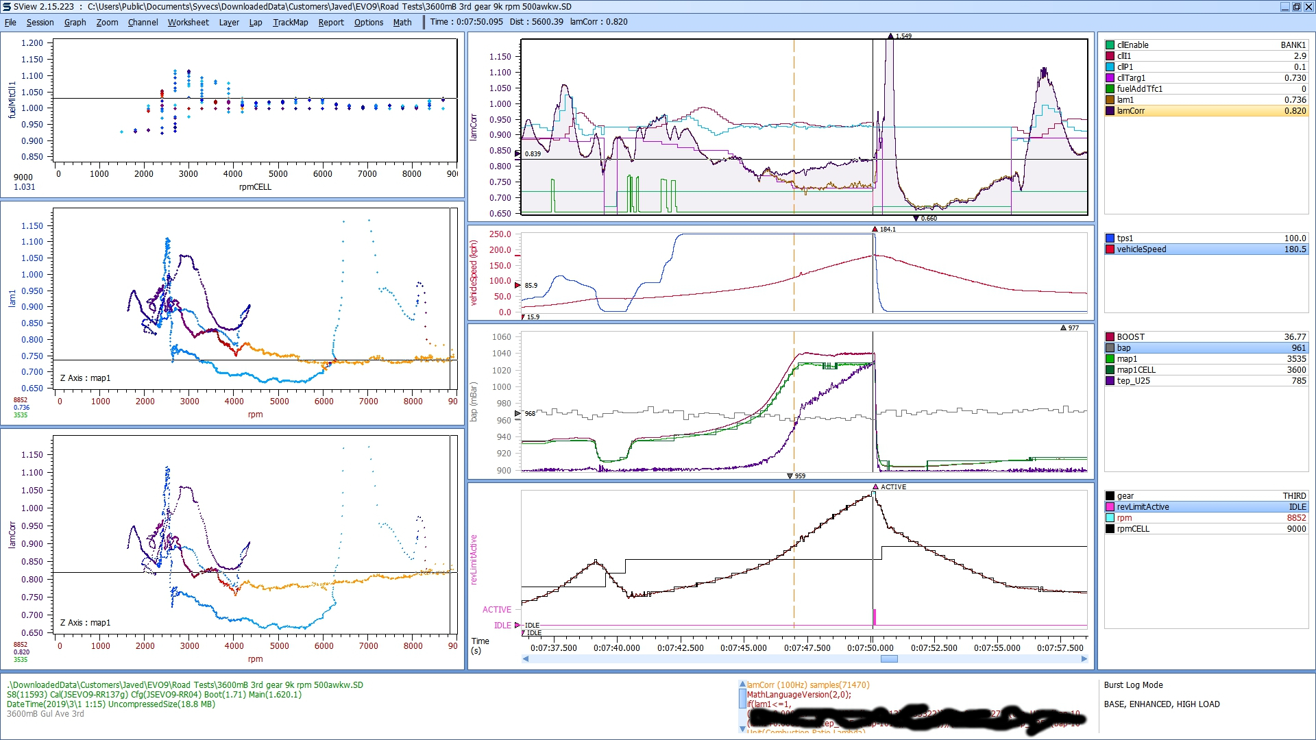

Pressure compensation, live action.
Done live via ECU/Dash or post process in analysis.

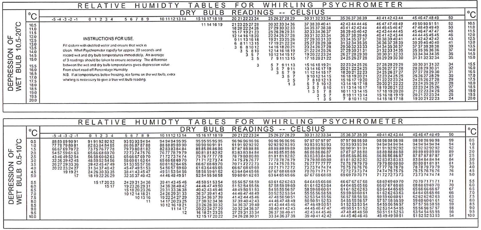

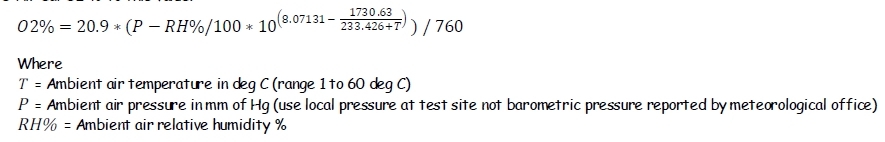

Here is a bit more detail on how to calibrate most NTK's for use in your Syvecs ECU
Something most don't get is the percentage of O2 in 'air' varies based on conditions.
It is pretty easy to check you just need a formula and some basic instruments and a table.

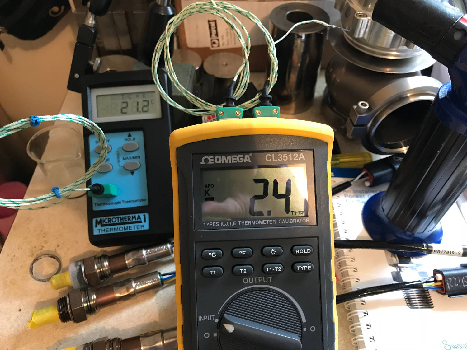

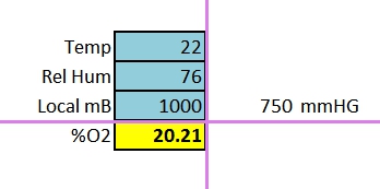

First check your relative humidity on the location where you are calibrating your sensor, simple to do with thermocouple and some water, get dry 'bulb' and wet 'bulb' reading, the delta between these two look up your relative humidity. Then get your map sensor reading for your pressure at your location, you must have localized pressure. Calculate out the percentage of O2 at this point in time and put that into your O2 instrument. If you don't do this the rich and lean spans will be out by a percentage, just as they will be in the Syvecs when you check you sensor calibration which I will display graphically below.
It's not an earth shattering difference but it is another thing to be aware of if you are flying a plane OR racing up a mountain, let alone if you are running on different days especially if the temperature and relative humidity are high V's even a constant altitude.
accuracy on different O2.jpg (556.37 KiB) Viewed 159261 times
So here is the technical info for those who want to do this.
The errors are more extreme as you get to upper end of lean and lower end of rich scales, so if you for example dont do this or have a reference meter that is shit then it can be over 15% wrong! on a Diesel for example or on an extreme boosted engine running full rich over 7% wrong.
O2 formula.jpg (71.06 KiB) Viewed 159246 times
RH wet dry bulb chart.jpg (1014.05 KiB) Viewed 159246 times

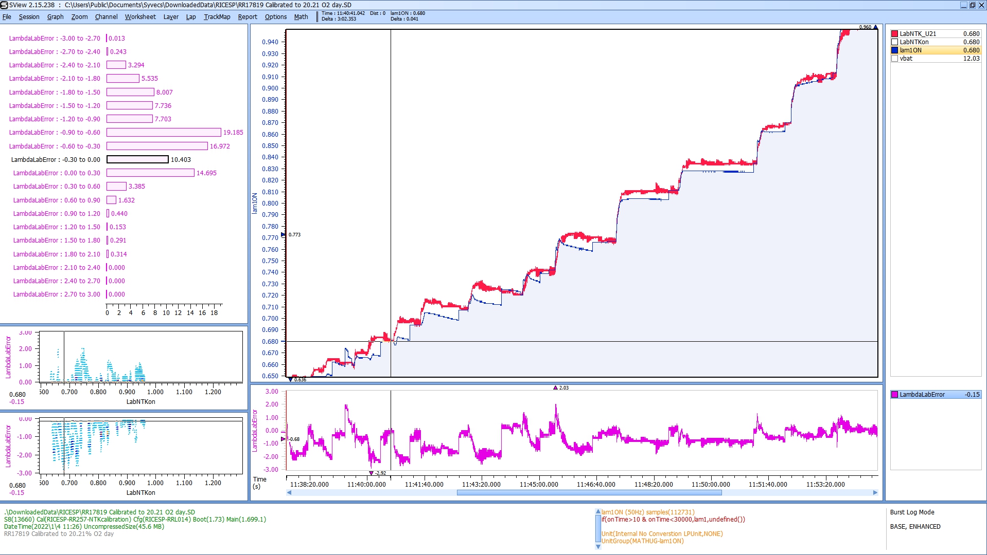

Here is the adjusted sensor report/cal test.
If doing these each day the cal is run the reference meter needs to be updated to account for test atmospheric conditions, if you want it to be ultra accurate.
For most performance car shops this wont matter :lol: as they only look at their sensor when it stops working ! let alone understand how it works in most cases !
Correct DON.jpg (766.39 KiB) Viewed 159246 times
20.21 percent O2 cal.jpg (24.59 KiB) Viewed 159246 times
