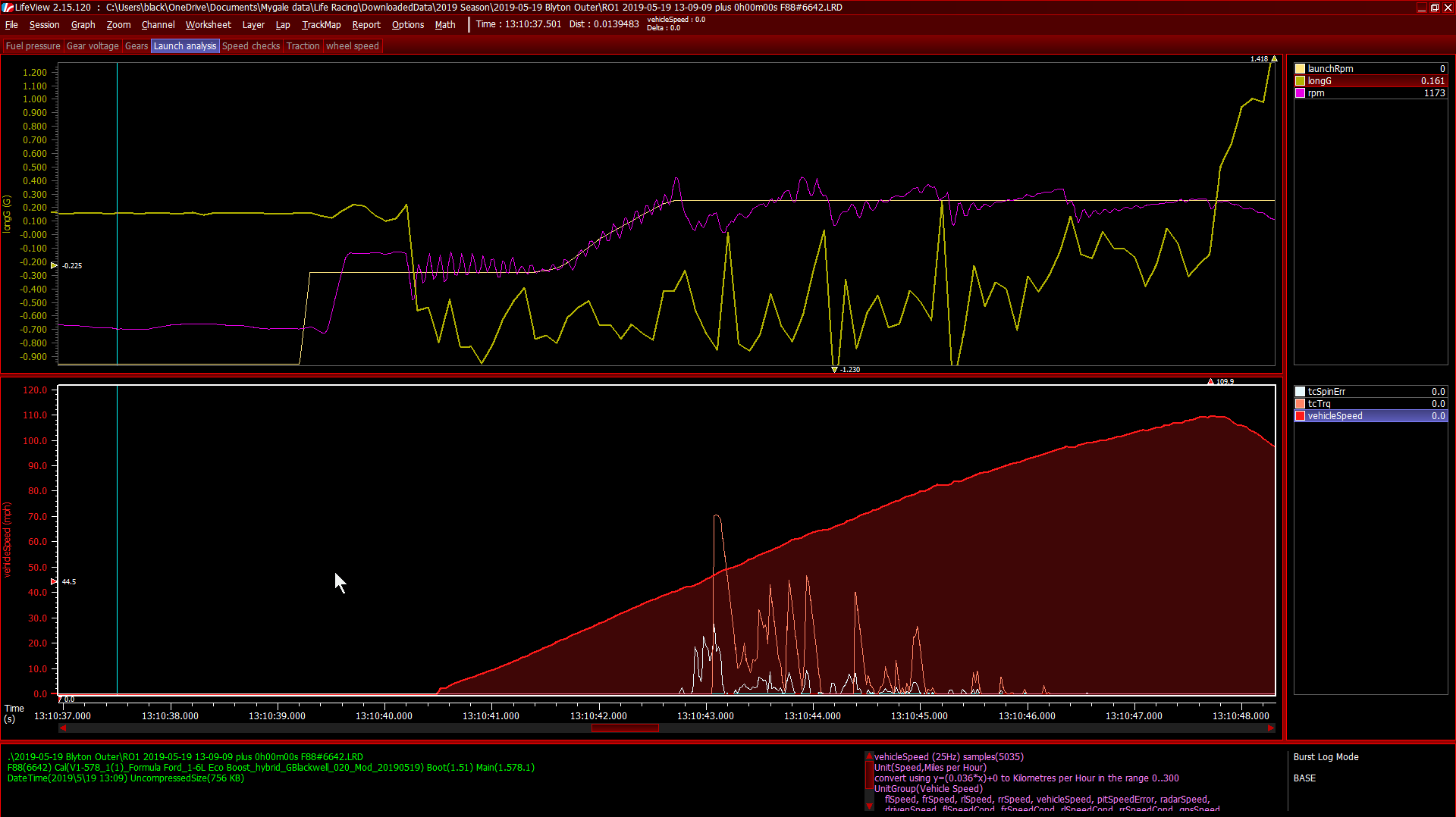

Q) What key do I need to press to get the data to appear inset in the graphs, like it shows on Ryans's Syvecs training videos? (see attachment)
- data in lifeview.png (18.07 KiB) Viewed 43730 times
- LC working properly.png (88.7 KiB) Viewed 43731 times

Options, All Toggle Options, Show items in graph.
Re: Launch Control Settings
Thanks I'd never have found that.

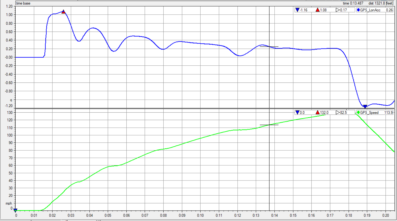

The trace below is from my AIM Solo GPS logging doing a standing 1/4 mile on average grip tarmac and then straight into a flying 250 metres. The most I've seen is 1.19G on a fairly rough tarmac surface. I've not launched the car on a high grip surface, but limit is my clutch anyway.
