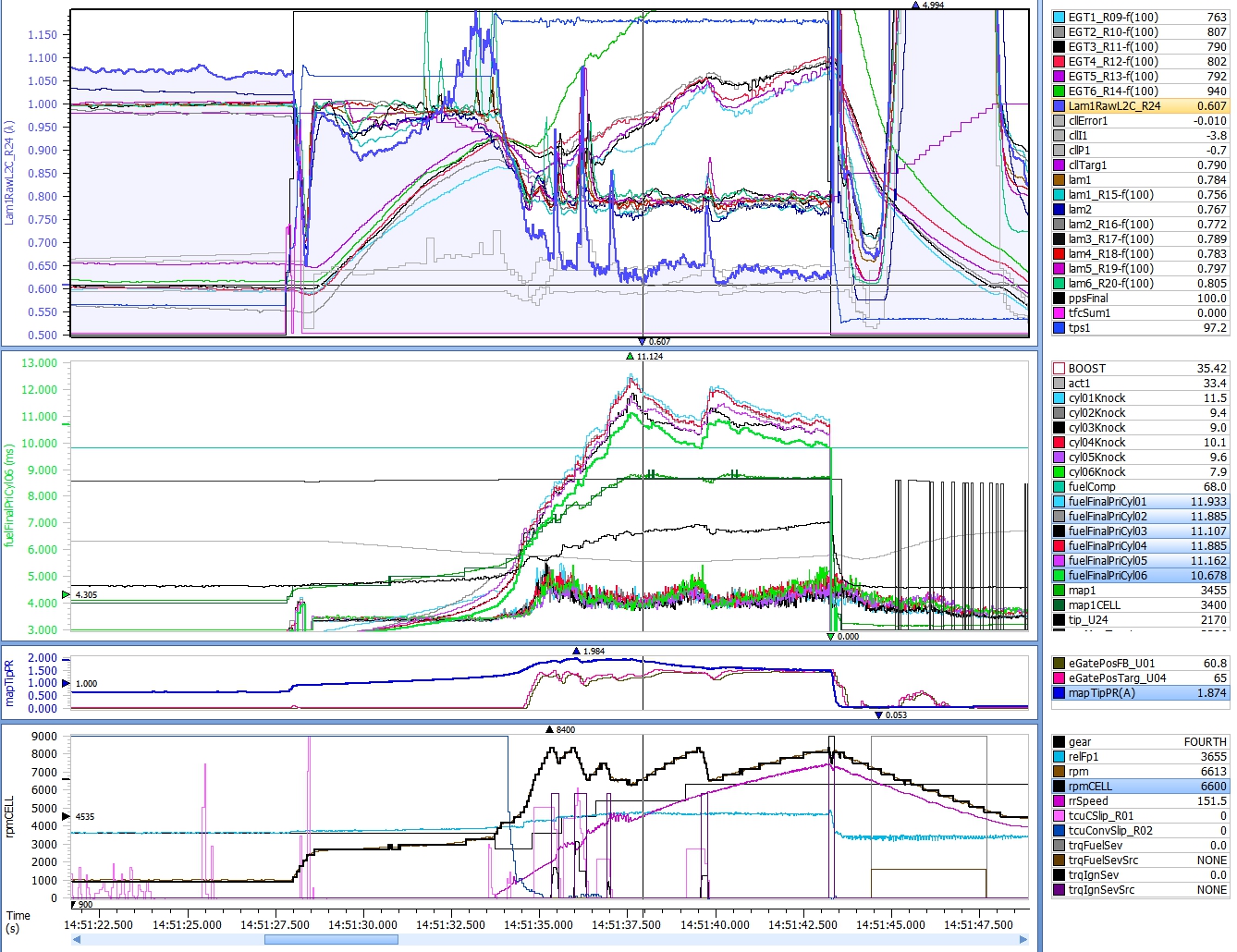

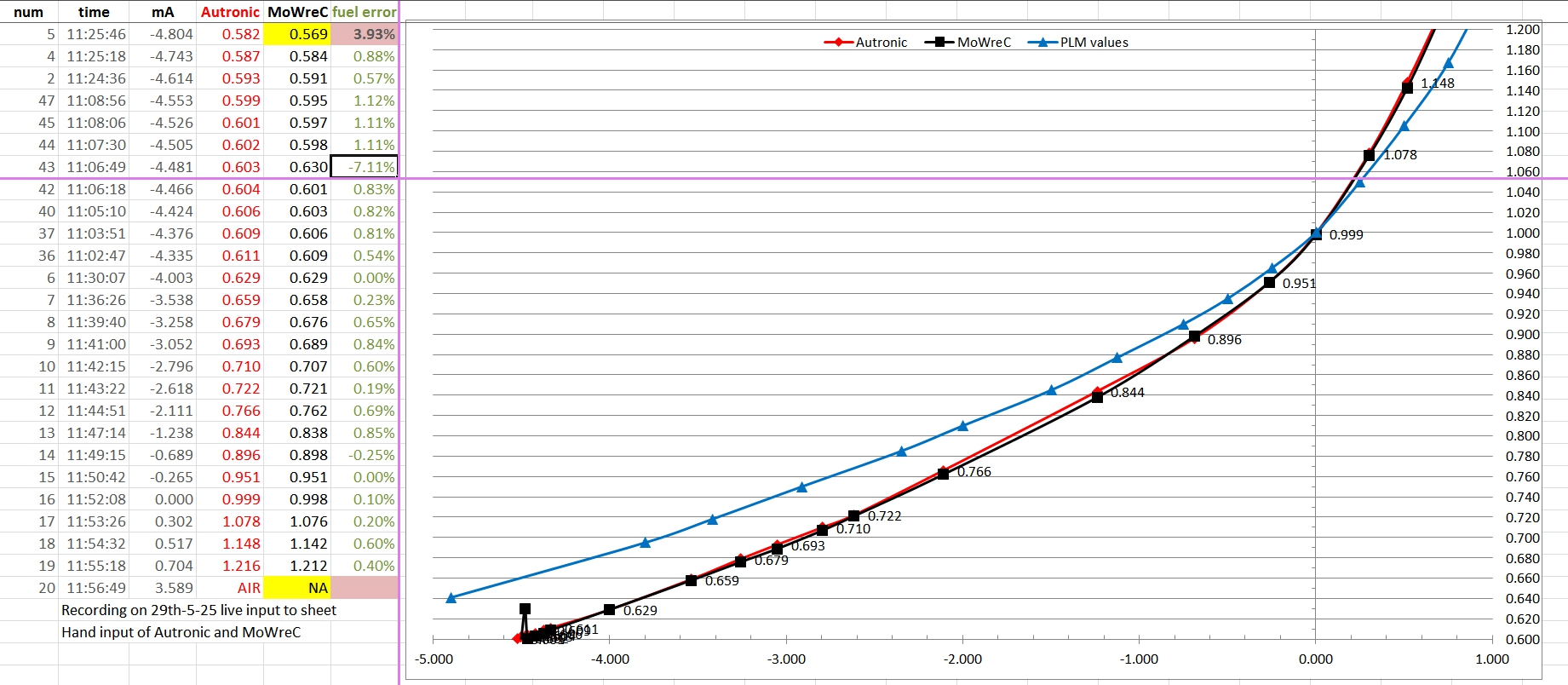

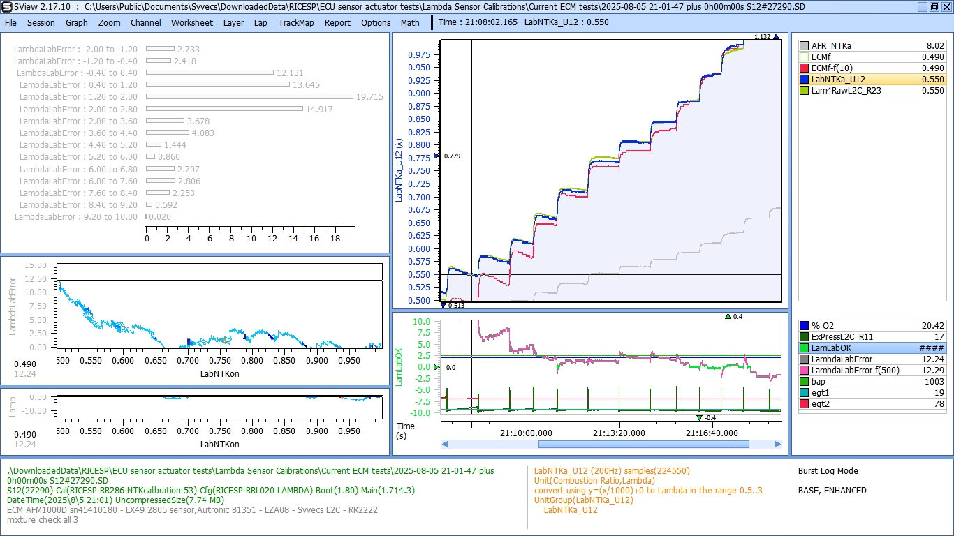

So below is showing effects of getting an out of the box NTK (meant to be fine right???????) not its not! never has been! never ever will be! these effectz are compounded the further in the rich or lean rangez that you go ! take note - pay attention
On a pre turbo sensing application you can see what I call lamraw which is biased richer than it actually is, these result in far bigger fuel errors than the paid on line educator dumb arses will tell you as they have zero experience or idea of what the fuk they are talking about !

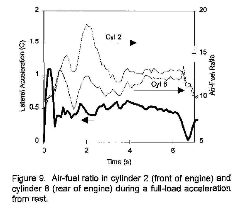

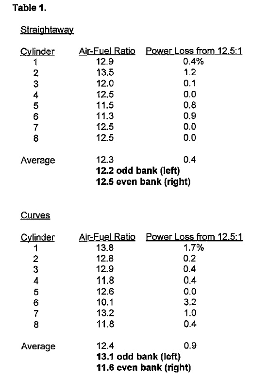

SPARK PLUG READING
its like trying to tell how much fuel you have left in your fuel tank after the engine stops V reading a fuel level gauge lol

keep in mind this is error in 'lambda' which is meaningless in terms of fuel, if you want to know how much this actually means where it matters then talk in equivalence ratio when looking at rich end (fuel) 22+% incorrect and biased the *wrong way* no wonder so many drag kuntz pop their motorz :lol:

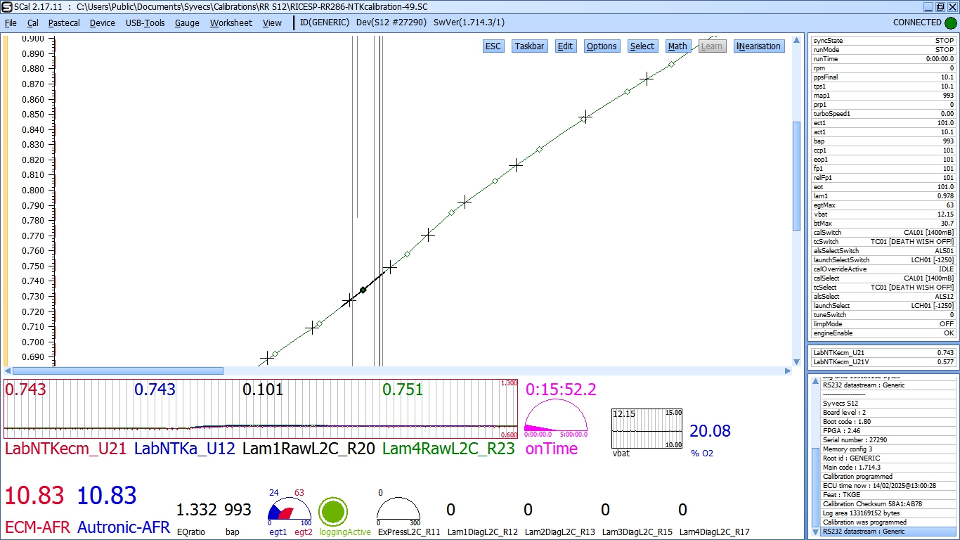

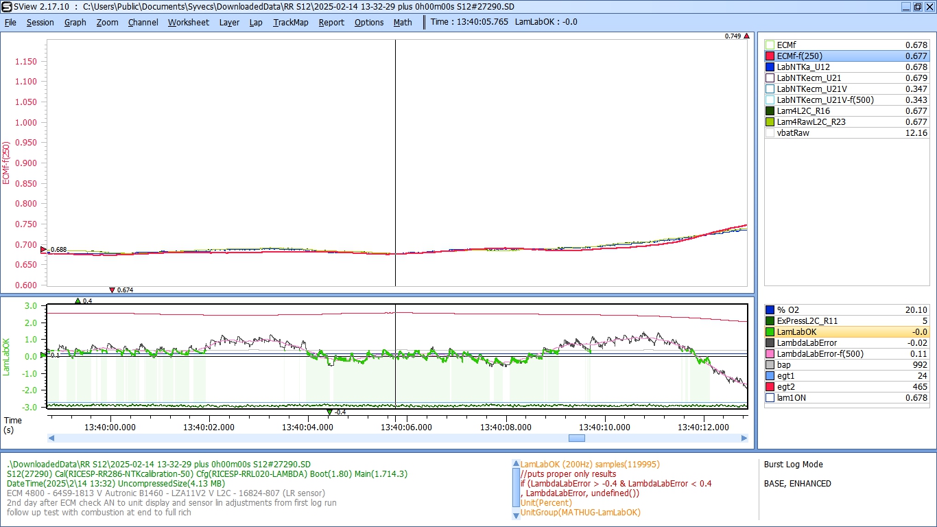

tested over 2 dayz
as supplied sensor
fitted brand new sensor (off my 4800P) and resultz :roll:
have you got your Syvecs lambda to can yet and RR calibrated NTK sensorz??????????
