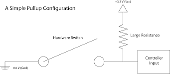

Connect a resistor from the S6 output up to a 12V feed.
This is a plundered image, but think of the "hardware switch" as being the S6, and the "controller input" as your instruments. Ignore the voltages etc!

I connect 12v into my existing S6-tacho line with a 1k resistor in? So that the 12V-pullup line and the S6-output both go together into the tacho?
so it is the green line you want me to add?
Re: MR2 - S6 – single coil conversion
Yep :)

As I said, I don't know your installation details or the car, but any tacho will need a signal that swings between 0V and 12V. Since the S6 only provides a grounding contact, something, somewhere, must provide the pull-up to 12V.
If your tacho already does this, then the resistor I've suggested is not necessary.
Will it do any harm? No.

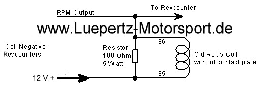

i have done a lot of Toyota MR 2 and Celica conversions from single coil to coil on plug or wasted spark Coil packs.
Most of the older Toyota Rev Counters are Coil negative Rev Counters which may not work with the above connetions because they need a voltage spike rather then a ground signal. My solution is the following circuit, which generates a voltage spike and works in most cases.
If it still does not work some Rev Counter may need a 220Ohm 5Watt Resistor instead.
Drehzahlmesser Tacho Signalconverter VW - Toyota - 1.jpg (18.5 KiB) Viewed 75504 times

I now put in a circuit Heinz suggested and I now have close to 4000rpm in idle ;) but at least I have some reaction and I am pretty sure, the rest can be sorted out with adjusting the signal pulses coming from the S6
cheers to you all
