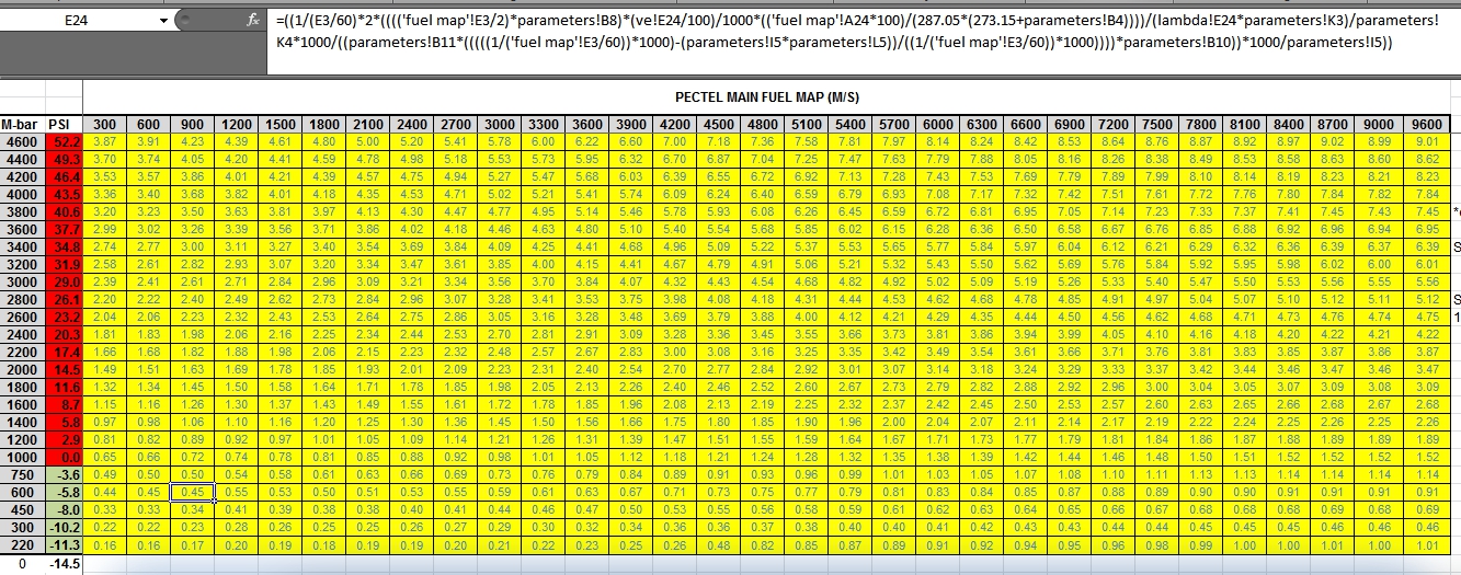

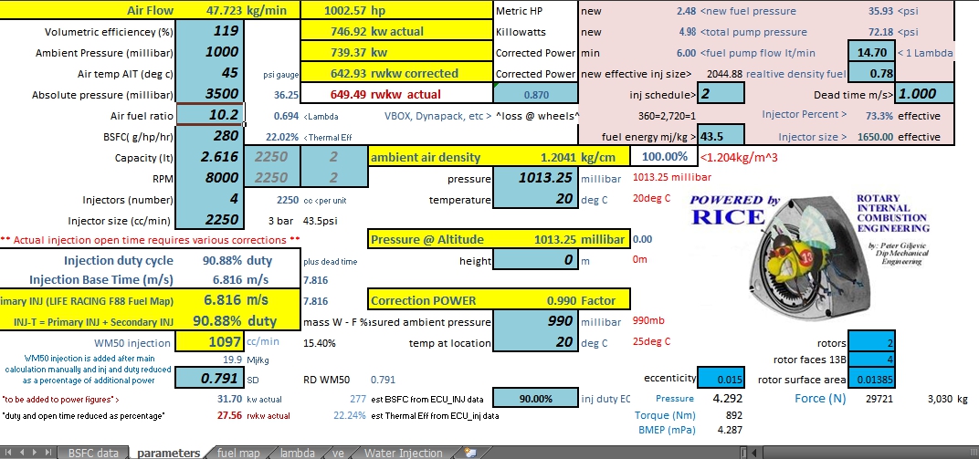

You can create a calibration spread sheet to help with mapping of these ECU, I made this when I ran my Pectel MQ12 and its the same for the F88, S8C etc.
I set it up to my break point values and it works on engines that use MAP and the primary load input. There are some fundamentals depending on the specification of the given engine where I use the TPS load correction tables to account for the change in Volumetric Eff (cylinder fill) for low throttle angles so it does not molest the base fuel table (which is automated)........ so I can generate a full fuel map to any MAP pressure and rpm range knowing engine and its bolt ons (from air filter to exhaust pipe) inclusive.
When you start out 'tuning' it does not have to be this complex, and 99.9% of 'tuners' of 'calibrators' have no idea how to do this, rather they tune by suck it and see methods, if doing it that way and working with the Syvecs you only need to be aware of the mapping trends of the typical main fuel map structure and you can graphically guess your way in a few iterations on dyno or road which way the demand is going, as per the video you posted of the engine being set up initially.
Nothing wrong with that, just you need some one experienced initially to get you in a safe range of settings, then there is nothing stopping you doing the final optimizations of it all, which will always need to be done anyway since it can never be accounted for in any dyno cell in my experience.

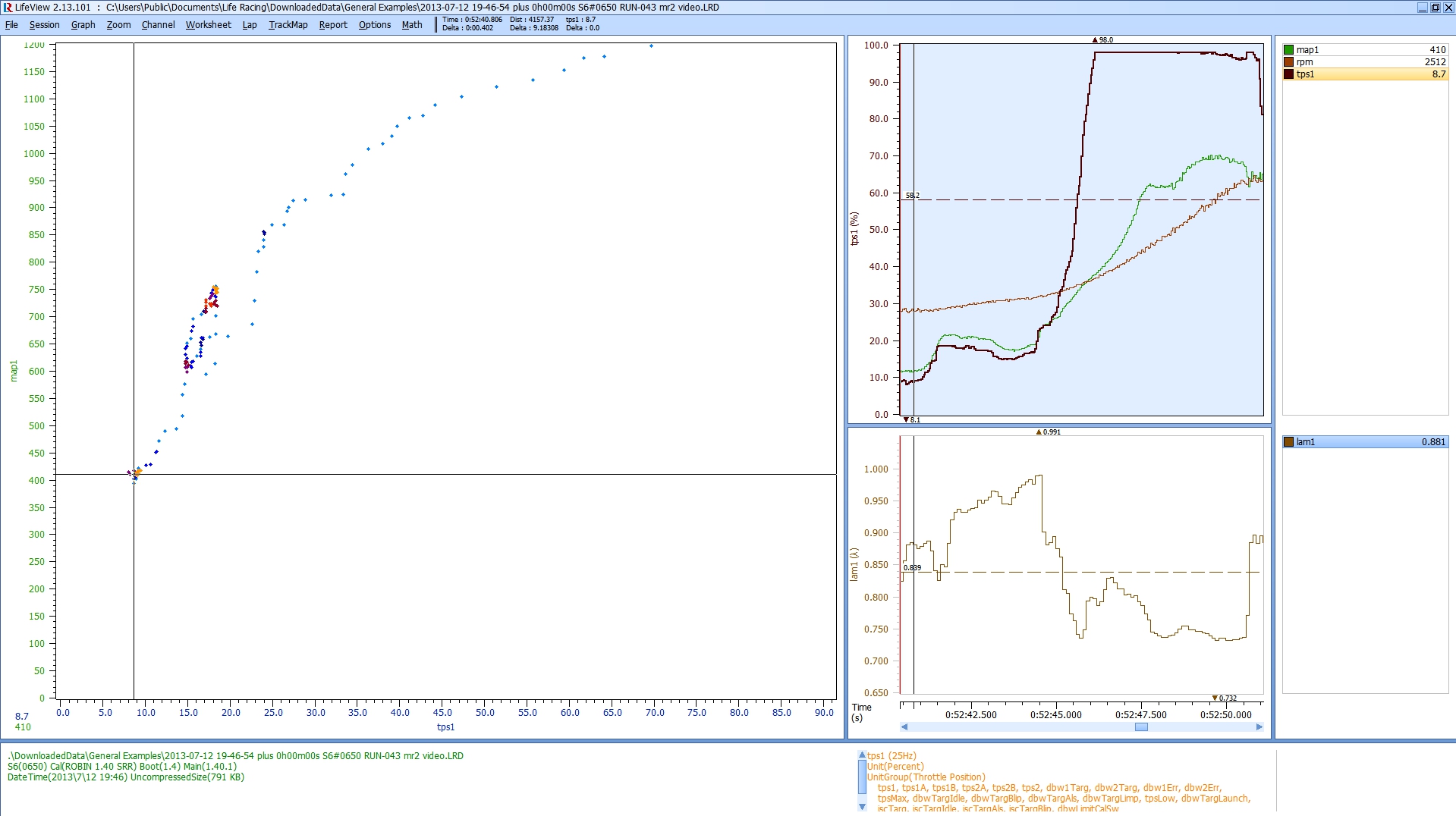

TPS to MAP
TPS to MAP
MRS tps v map.jpg (485.25 KiB) Viewed 45021 times
