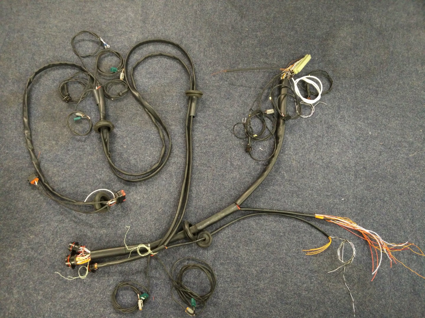

I know. Just keep stuff tidy. Why I mentioned that, I recommended it to a custom where the S8 needs to control the Subaru 5 speed automatic transmission in this legacy. Hopefully we can see the light of that this year.
What is the best implementation on a low cost budget to run the wires from the ecu to the engine?
Do I use bulk head connectors?

You are correct. I just dont like the idea off all of those wires all the way back to the ecu.
The car is my DD, so wanted the ability to keep it tidy between building and tuning.
Any recommendations for connectors and any pics that can be shown?
Re: Tools for making Harness'
Deutsch Autosport connectors are the ones many (and I) use. Reckon on around £200 for the connector pair though!
Here's a loom I was working in recently with 2x AS bulkhead connectors (before the DR25 was shrunk down, boots put on, etc.)
