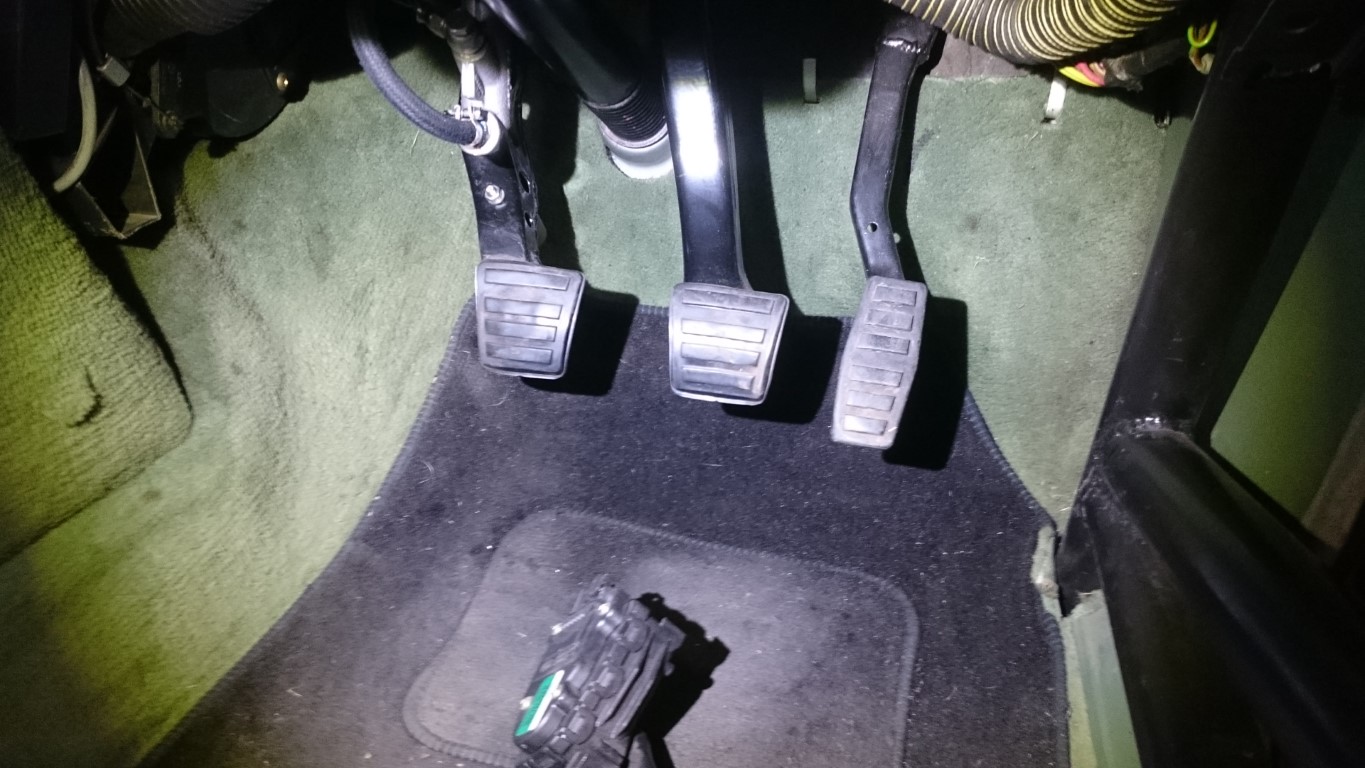

Obviously they offer plug n play kits for some Focus models...so there must be some options.
But from the picture you posted of a pedal...it looks like a simple bulkhead/vertical mounted pedal. Not too dissimilar to a Subaru pedal.

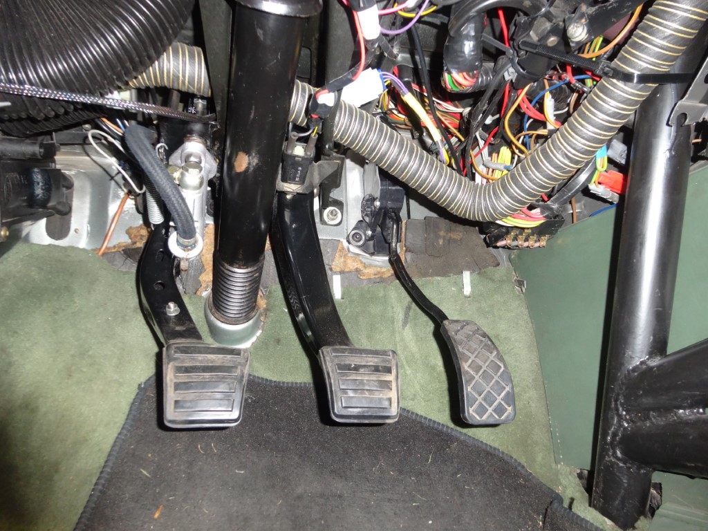

And the Subaru pedal with the metal arm means it's easy to cut/adapt/shape the pedal arm to whatever you want. I used the Subaru base but ended up putting an Audi rubber pedal lower onto it for mine so the pedal looked more appropriate for the car
Before
After
I had bought a complete Audi pedal...but overall it would have been far more difficult to use despite similar mounting arrangements
Before
After

Ok, got an email back from ryan,
“The Focus RS Pedal is a odd one, one signal goes direct to ECU and is PWM Signal based. The other signal goes to the BCM and then sent over Canbus.
For your project suggest to use one of a VAG car as they are 2x Linear Pots“
So that’s that then! Anyone want a mk2 or mk3 focus pedal haha!
