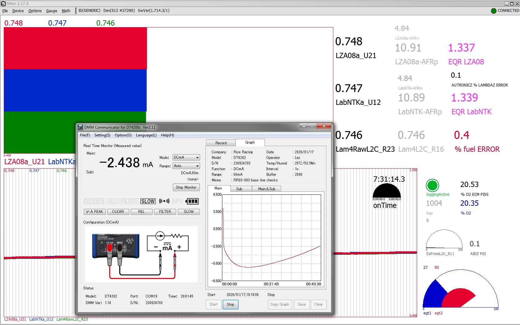

To dumb this down for people (since I live in a bubble and think everyone understands what I put up here) every single 'RR' banded sensor is calibrated ! so what I am illustrating above is the simple well known fact that if you run a well developed curve but apply it to a random sensor supplied by anyone who has no idea of these effects you will have a wildly different reported mixture !
These are actual figures I guarantee, anyone is free if they have the ability to run it up themselves to validate my findings but a majority of my customers (shops etc) are already very familiar with this from their 'real world testing' the implication here is unless you know you have no idea why some chambers are running different to others. This happens on all systems all electronics, does not matter if its a $20,000 dollar ECM or a homo branded $200 piece of dog shit sold these days.

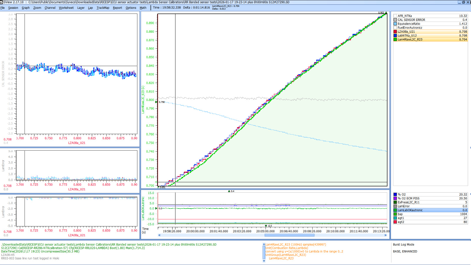

This is real live action:
SPREAD MASTER
Showing hot swap one sensor from a box (same batch code) to another, not this is not the largest variation seen but is what I would call a normal spread based on the hundreds of these I have calibrated over last 10 years for people, anyway this is the A typical 5% fuel error you will get if you dont account for it at this level of excess fuel setting in your ECU.
RR PROOF MASTER 4
The other pic is taking any RR batch selected sensor and hot swapping it in LIVE ! unit turned off, sensor changed out, unit turned back on, no other changes ! proving that RR hand selected sensors can be interchanged and run on the same RR calibrated supplied curve, this is a 'god send' for shops with engine dynos who are running multi cylinder set ups or multiple dyno rooms keeping just one calibration curve and cutting down the need to do multiple set ups in each which can get confusing and tedious to say the least !

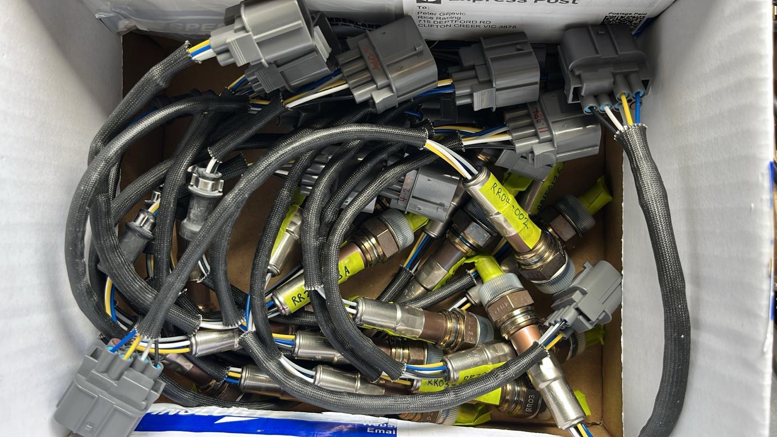

Another week another box of sensors to go out around the world
'if you know you know'
all the best shops and smartest individuals run RR NTK banded sensors, this was a batch of 6mA new unitz sent in for kalibration and a small portion of 20 otherz of my 4mA donmega unitz, also some RR BDS9 meters going out to a couple of klientz

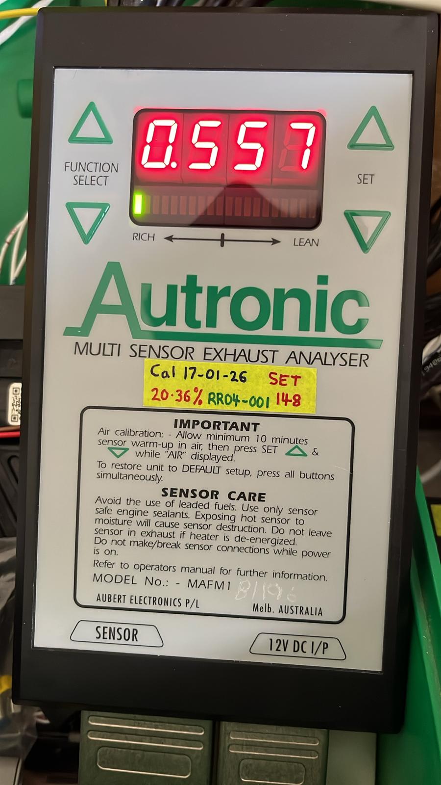

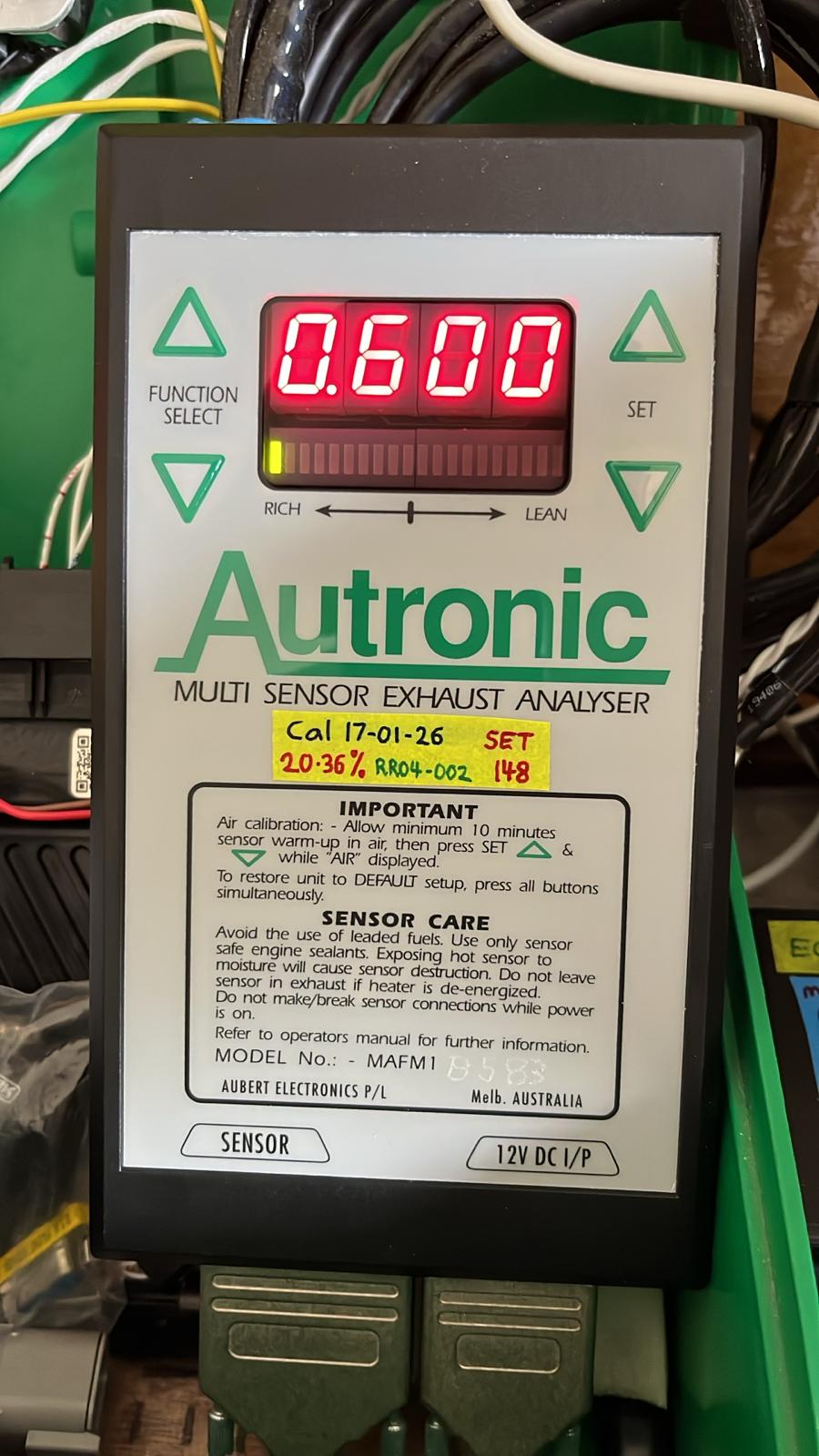

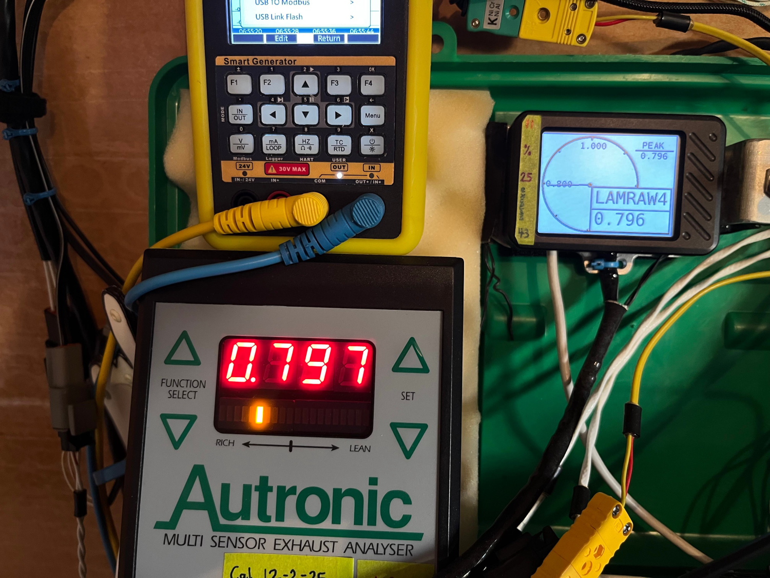

A random sampled RR batch unit being run up, every sensor goes through this process for it to be DONMEGA
