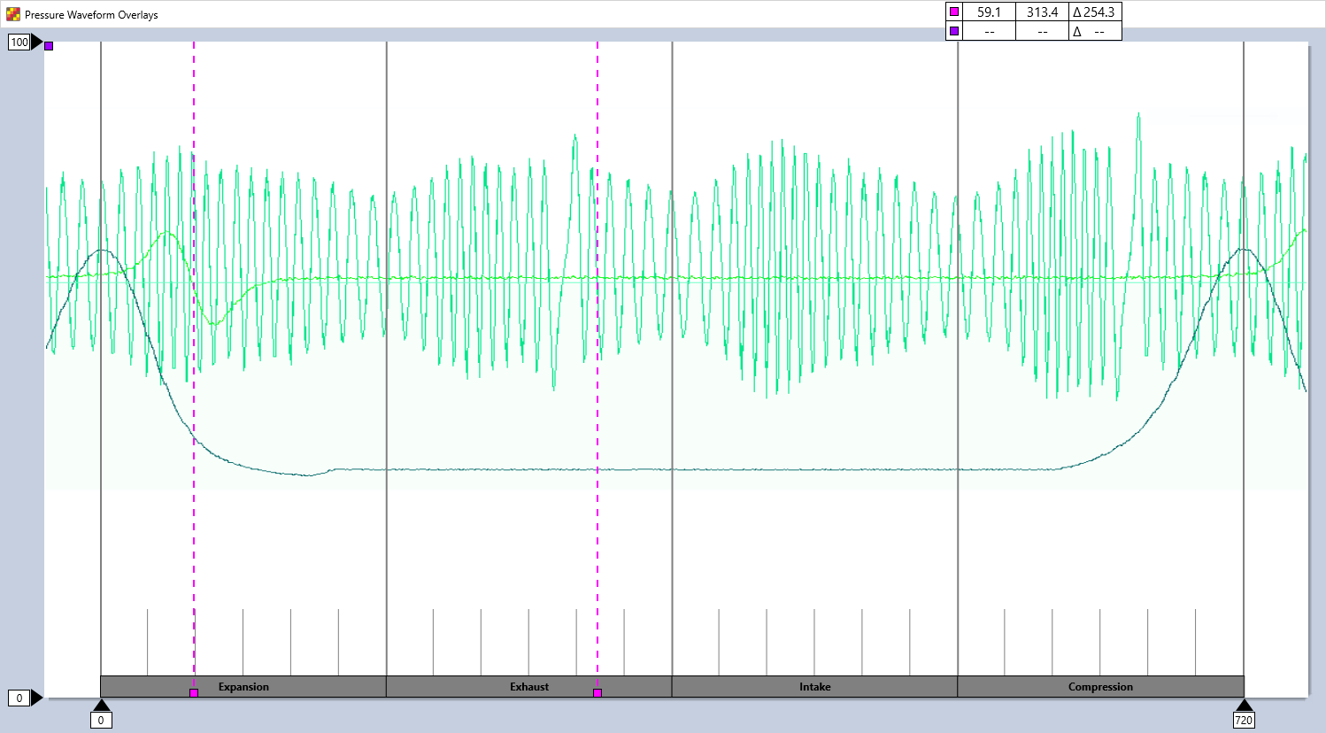

Any Ideas? iv attached my Cam/Crank Sync log as it doesnt look right? Its a very weak signal but if i rememeber right it always has been?

- crank log dsg focus.txt
- (230.74 KiB) Downloaded 1291 times
The signals are clear and defined, but not being recognised. Whether that's just voltage thresholds or completely wrong setup I do not know without seeing the setup
Also I would say your cam trigger is wired reverse polarity, although it may be ok on rising edge. But I would always prefer the trace the other way around and falling edge.
I've never used a VR trigger on rising edge, so cannot comment how viable that is.
But with no green lines appearing in the syncscope, it's not happy.
How did previous syncscope traces look before ? always keep some handy for reference

I checked the old set up and as far as voltage thresholds go and rising or falling settings that are as per the old file.
As for wiring I checked that first and it’s again as per old set up.
The real change here is the crank, Iv moved to a trigger wheel on a pulley on the crank vs the original which used the flywheel for its pick up. I think it might be a sync issue?
Hmm maybe passing my level of knowledge here now
might be time to get someone with a teamsveiwer set up and a timing light to see what’s going on!

as already said, it is not recognising your current setup.
I've no idea what you had before, but it is not right for what you have now. Clearly something is different
Make life easy for anyone trying to decypher what you need through all the vagueness.
Stick a pressure sensor in cylinder 1, and log raw crank, cam and the pressure sensor at 1000Hz during cranking, and it will make it easy to sort the crank/cam setup.
ie. you can easily see crank cam and where all teeth are in relation to cyl 1 TDC
