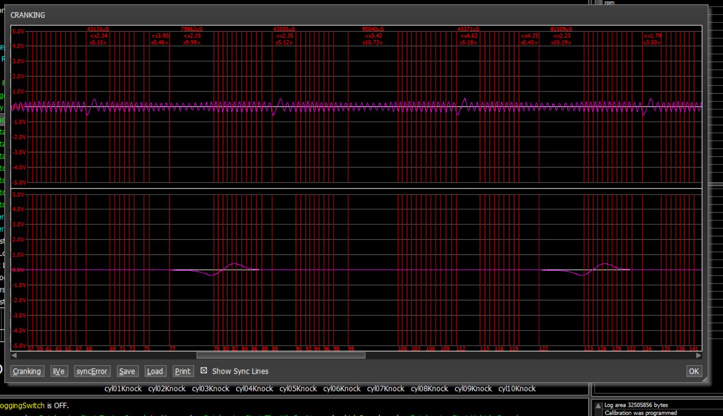

Not the quickest tbh. If i add a gauge for RPM and set it to a high refresh rate and scale it to 1000rpm i dont see anything showing
Not a specific answer.Jackstrath wrote: Fri Jun 16, 2023 6:03 pm Not the quickest tbh. If i add a gauge for RPM and set it to a high refresh rate and scale it to 1000rpm i dont see anything showing![]()
datalog it. You'd hope it cranks higher than zero

Yeh its showing zero RPM, looking at the sync log the signals from the crank/cam are very very weak.

- crank.JPG (233.84 KiB) Viewed 85453 times
I'd say yes, your voltage thresholds are not low enough for it to "see" the teeth at the speed it is currently spinning at.
And for me, I'd also say the cam trigger is reverse polarity ( or else possibly using rising edge might keep it happy ).
It will never start when the syncscope is red like that
Adjust settings and it should work ok

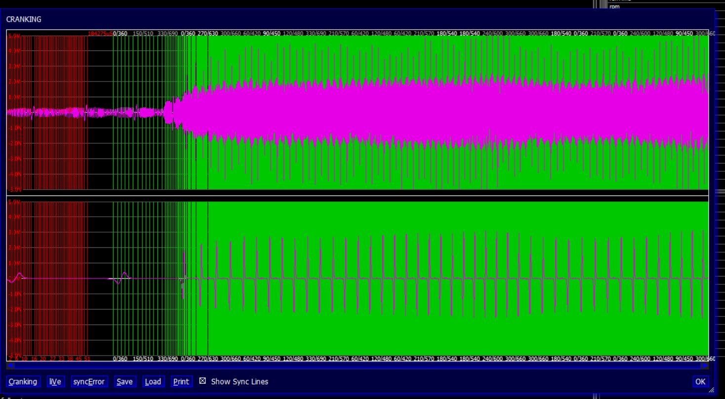

Jackstrath
- Posts: 160
Sorry to be a pain steve but what should I be wanting to do?
For ref the crank & cam is as follows for 100rpm on
high trigger : 0.25
Low trigger : -0.25
Do I want to open these up to say - high : 0.45 / low : -0.45
Or close them down to say - high :0.15 / low :-0.15?
high trigger : 0.25
Low trigger : -0.25
Jackstrath
- Posts: 160
got it!
- cranking start.JPG (187.29 KiB) Viewed 85450 times
looking more healthy.....but that rising edge/reverse polarity still annoys me lol.
