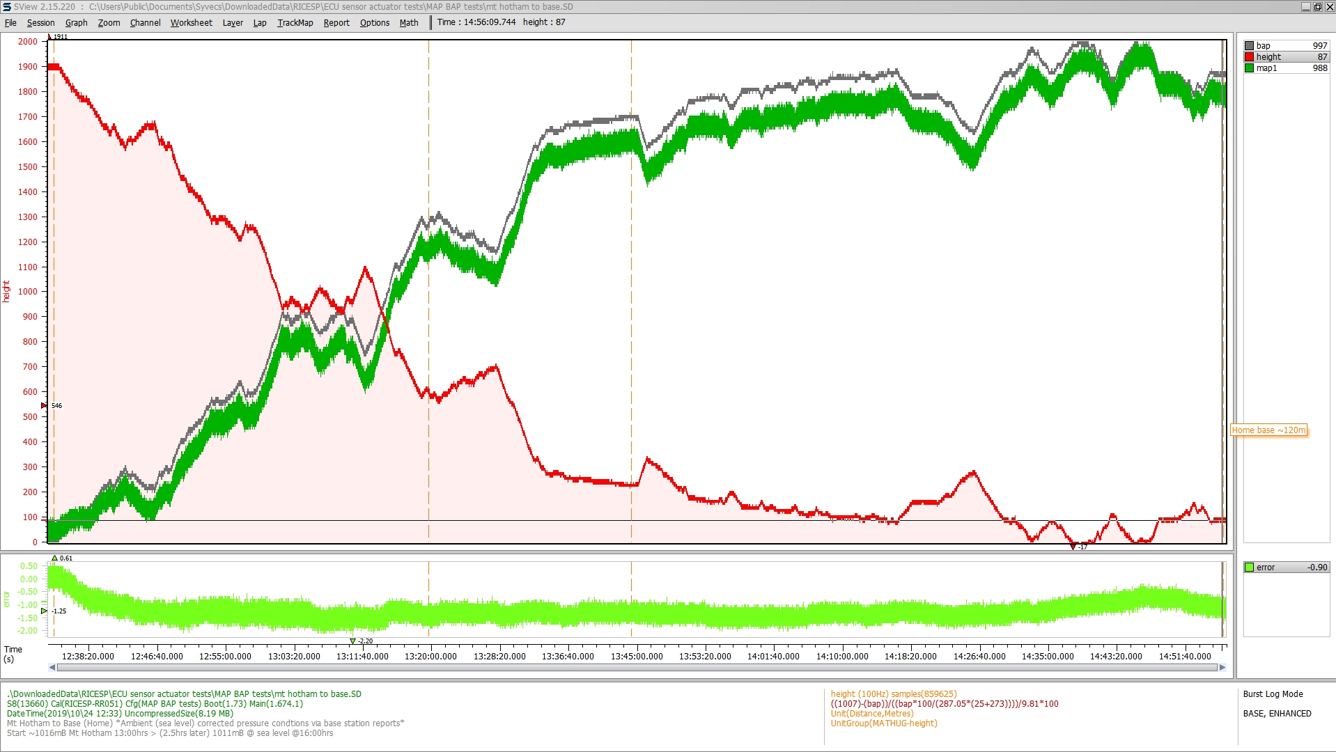

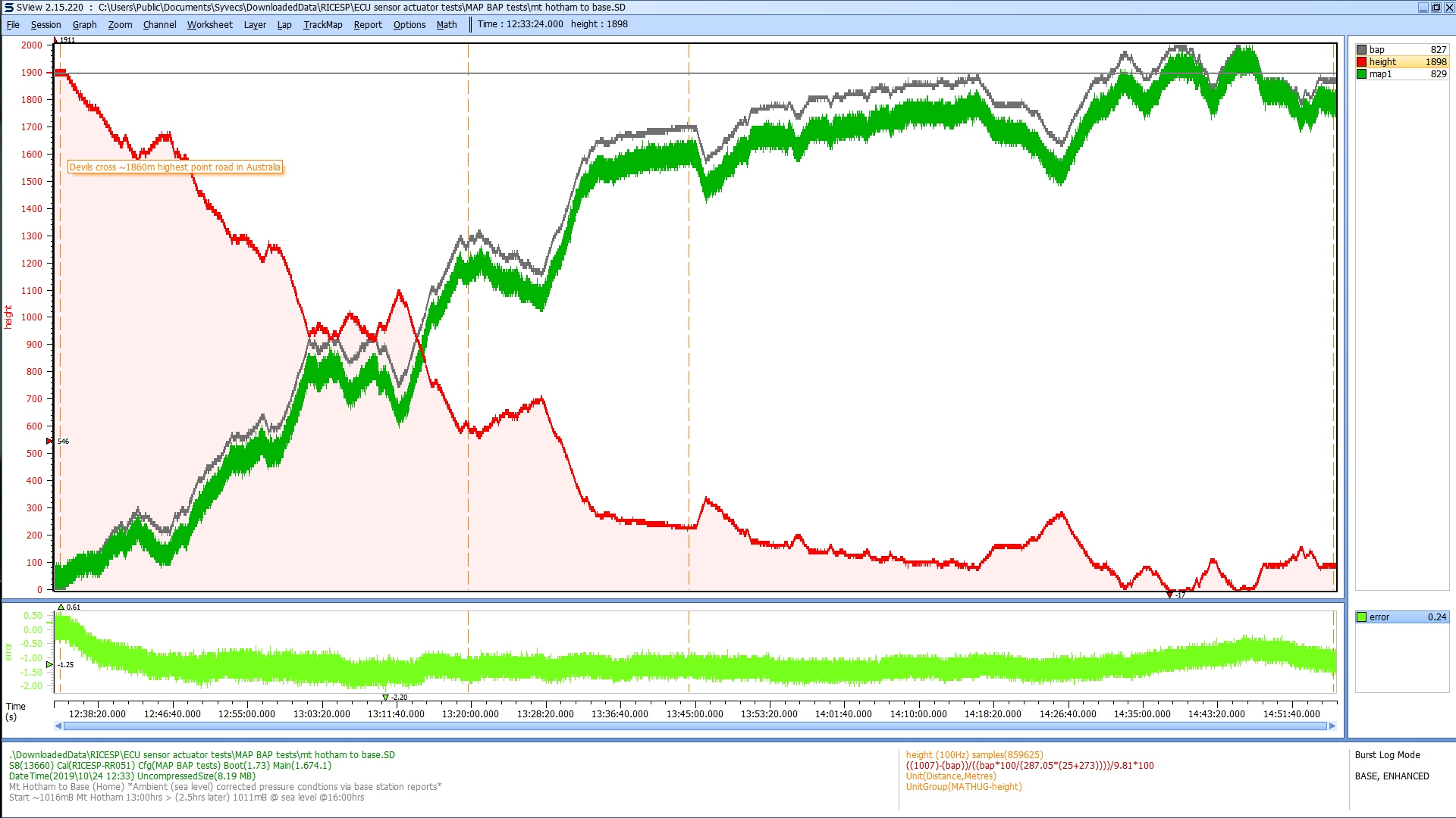

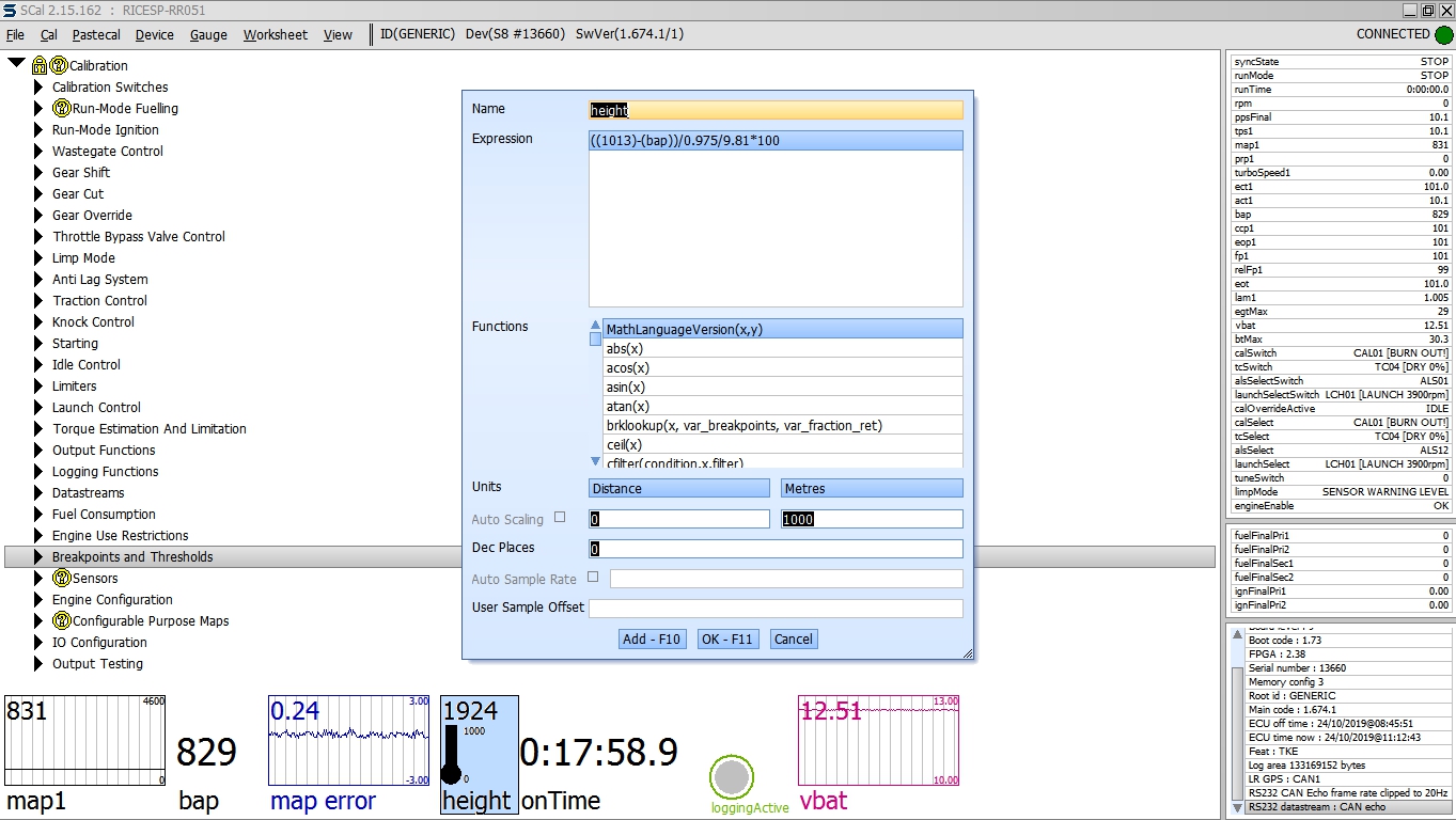

and yes I have driven from sea level to 1850m in two hours to check these things and derive my own altitude to height formula
gayer 5.jpg (468.43 KiB) Viewed 25887 times

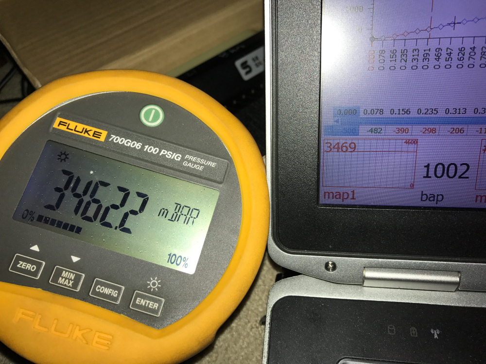

if you have nothing else a penis pump and a reference gauge will suffice as I use to do a long time ago below
penis pump13.JPG (249.61 KiB) Viewed 25998 times
