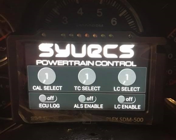

The new Plex firmware combined with the S8 is really a treat. We now full implementation of all 3 trim switches and 3 digital switches through the dash. The S6 and S6Plus are limited to a single trim switch. All of the switches are now user definable as well.

Yea, that screen never did work correctly with my S6.
That said, I would never want to use that method for actually changing cal anyway. I like the simplicity, speed, reliability of a rotary mechanical switch I can always get a visual on.
So I dont even use that screen at all now.
Although it's handy that the Plex does a pop up when you change Cal too.

I run a Syvecs S6+ with a SDM-500 GPS Syvecs Edition in my Mitsubishi Evo and this combo seems no to work like advertised. :cry:
The cal-switches on the dash and the datastream back to the syvecs are not working properly. I can’t dial the maps via the Plex and the syvecs cant receive, for example, the GPS Data.

The Cal/TC switching via the dash has never worked as far as I am aware.
It can work for the S8 I think though, but the S6 CAN is the limitation. But TBH....a nice mechanical switch really is a better option.
