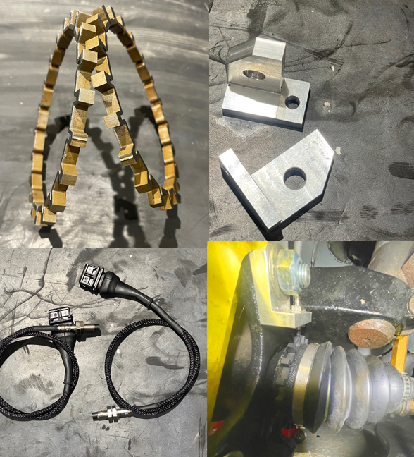

Its more for reliability now, i always had the fear the bearing flex in the hub might cause me issues down the line once i get on track, this set up on the CV removes that issue all together.
Ground going into the sensor ground wont cause issues?
Yes, it will be as simple as that
Depending on inner CV type, some of them do move about a lot though which may cause issues. Although the big chunky teeth should help alleviate that risk

So rather than leave you in the dark steve, thought id show you what iv been up to.
Got some sendor rings made, 20 teeth so ties in with the beek soft wear recommendations. Got some little brackets to hold the new 10v sensors.
Wired them up and fitted it all up. Few changes to the thresholds and set to 5v rather than 5vbipolar and i took it for a spin and opened it up and all seems well. No issues, got that torque limit trip again. Was something to do with me controlling the idle while on the brakes. Doesnt like that for some reason.
Set the speed using my GPS so the speed is with in 1mph at pretty much all times, but still getting the fault codes in the box. Will send another email to beek see what they say!

So largely the change is just the trigger rings ? same sensor ?

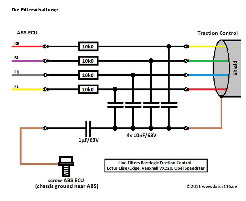

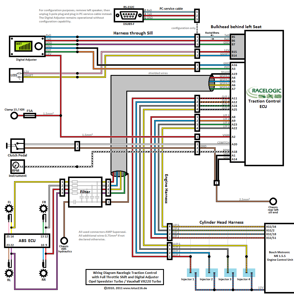

Or I see many in the past who've fitted Racelogics TCS, they do wire the OE VR wheel inputs to the RL system, but with some DIY filtering added. I'm a good way off doing either at the minute though
But the filter might be a way of wiring direct the the ecu, and keeping the ABS itself happy. Although if the Bosch system could talk to the ecu via CAN, that sounds like a good upgrade all round.
