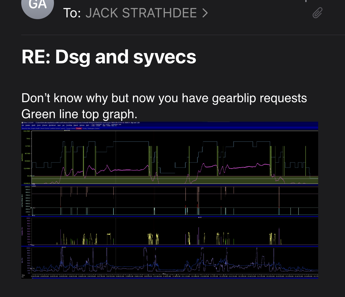

When you compare them to what's happening at shifts, the gear cut and blip do definitely occur at a shift point when you view the slaveAN values.
So they are being seen

But it looks (for the blip anyway) to be occurring after the gear has been selected and not during or before. Still doesn’t explain why I’m seeing no gear blip request tho?
their names are not the standard names for shifts and cuts etc, so they must be using the custom tables to do something ?

Well beek just got back to me. Interesting it looks like they are actually active on? I never looked to see if the requests had came back? Man this is weird?
- IMG_5034.jpeg (453.5 KiB) Viewed 89042 times

So, iv figured out why the blips and cuts have started working (and wow what a difference thats made to the box downshifting)
So i changed my switch panel up and moved things about, but i then fitted the cal select switch upside down..... so when i got in the car i just set it to cal1 but turns out that was cal8.... now cal 7 has basically the safteys turned off so if i hit a sensor fail mid race i can cancel it and continue. Im wondering if cal 8 has something activated that allows blips/cuts to work and cal 1 doesn't! i have had a look but i cant see anything obvious under the calibration switch tab?

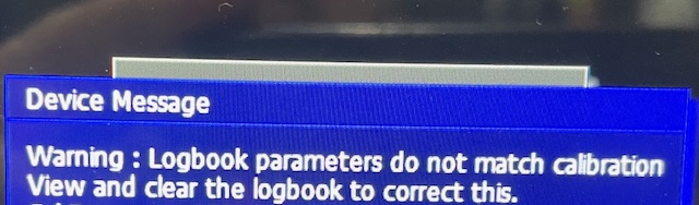

One thing i cant seem to shake is a error message for the logbook, iv tryed changing things, making sure the log book is set to the right version and clearing the log book but i cant seems to get this message to disappear? Any ideas?

That happens sometimes when changing firmwares.
Damned if I can remember specific route to clearing it, but need to do as it says really by clearing the logbook. I think Device/Logbook ?
Or maybe clear the datalogs in SData ?
