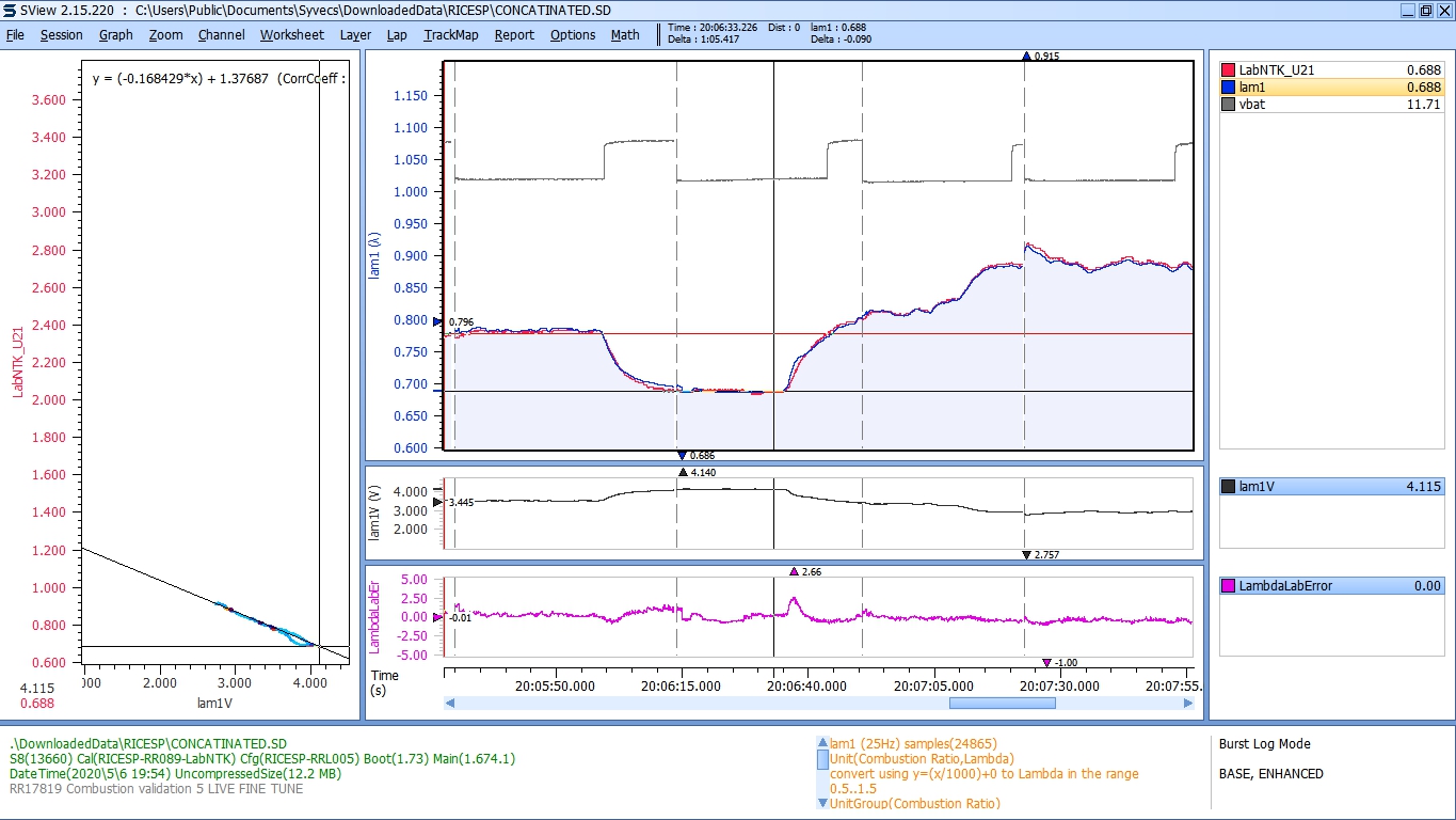

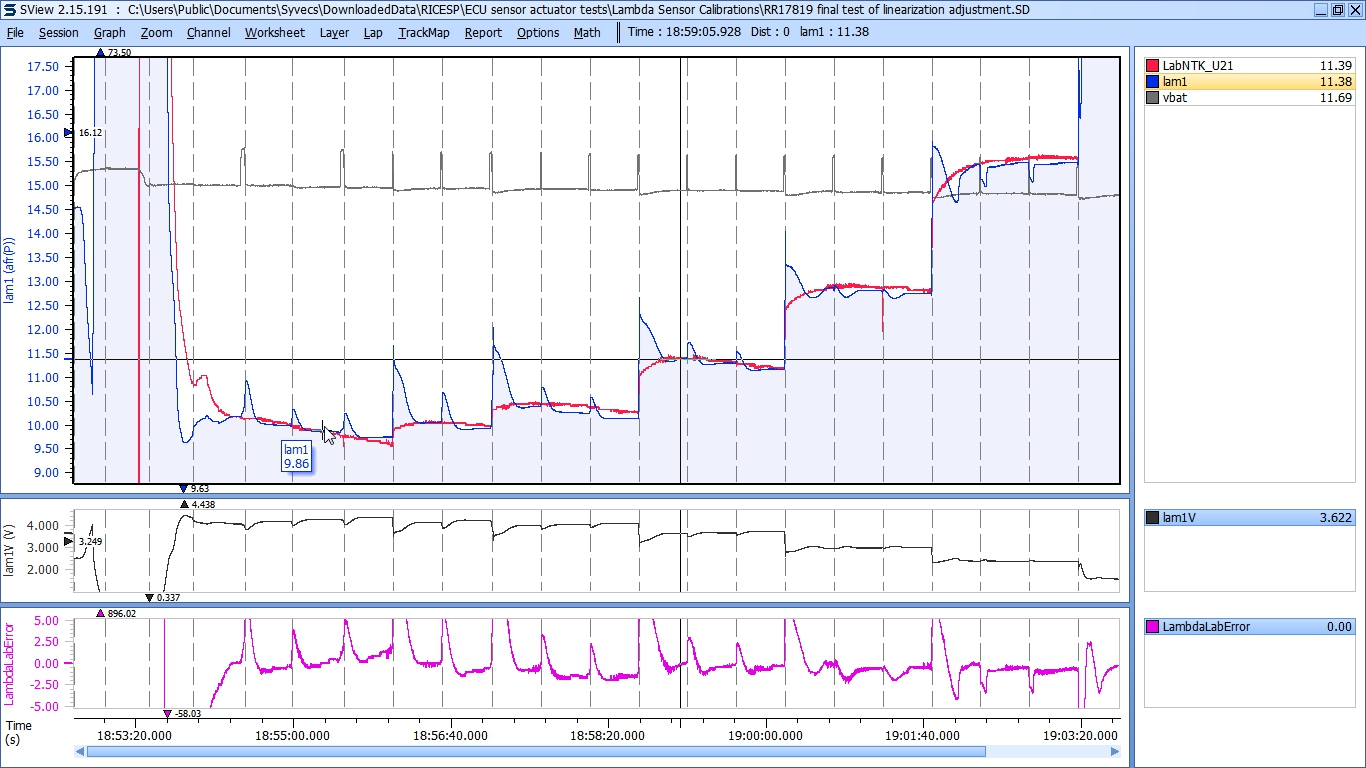

Here it is in picture form, as some hate Lambda or understand a percentage differential
Once completed you can get it very close or as much effort that you want to put into a bespoke individual sensor calibration that is

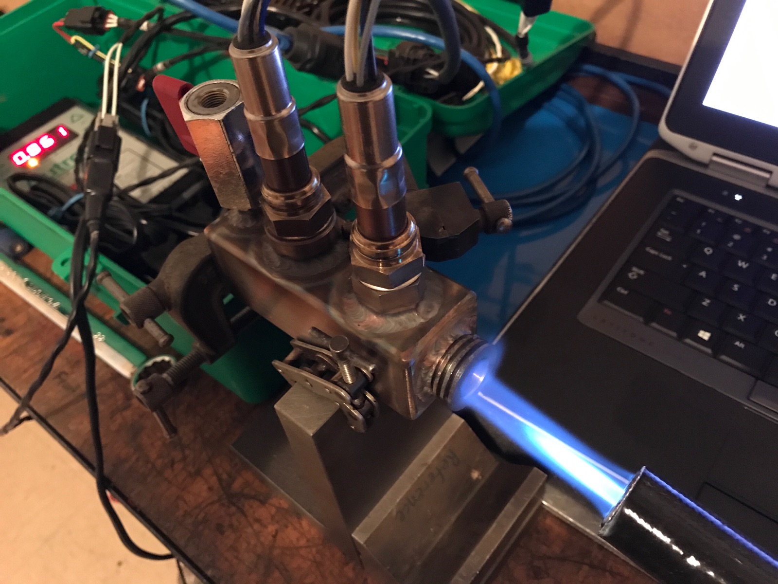

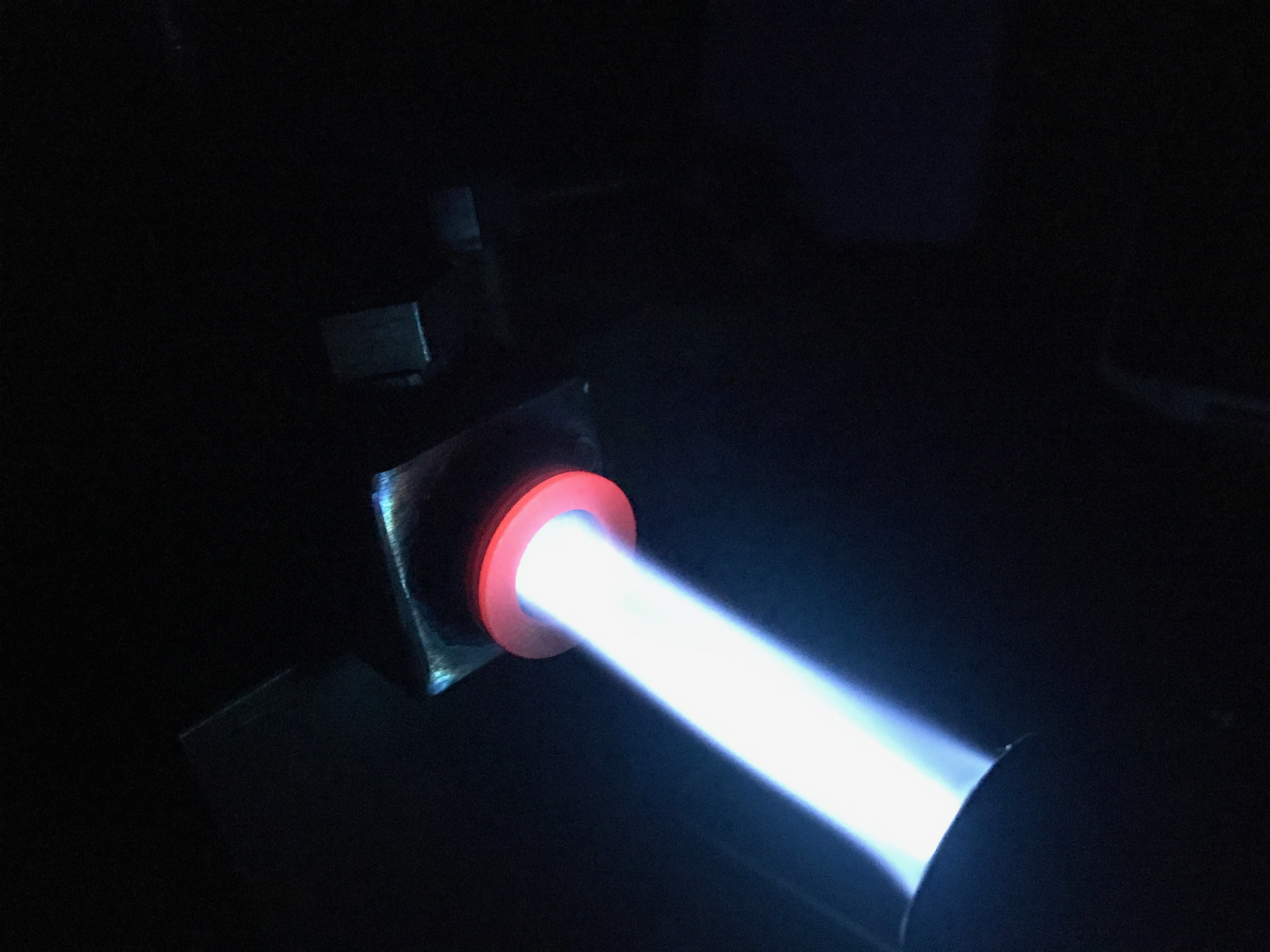

Did a batch of varying NTK consumer grade sensors and thought would put this up showing the process some more for those interested.
Video > https://www.youtube.com/watch?v=r1r2wl4 ... e=youtu.be
A few hundred iterations later you can get it to this level of precision, these are LZA09 sensors to lab grade NTK reference.
Another RR enhanced 'shit box LZA09' off the production line thinking its a Lab Grade NTK
