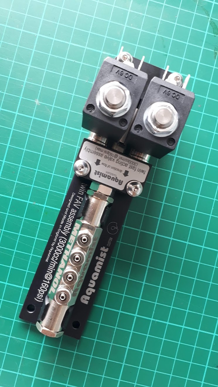

Ah only thing I can contribute is have 4 different cars on longer term test *running since ~2017* using the Aquamist combine twin HSV and flow meter manifold unit. I cant vouch for accuracy of the flow meter but they seem repeatable,reliable, and durable so far.

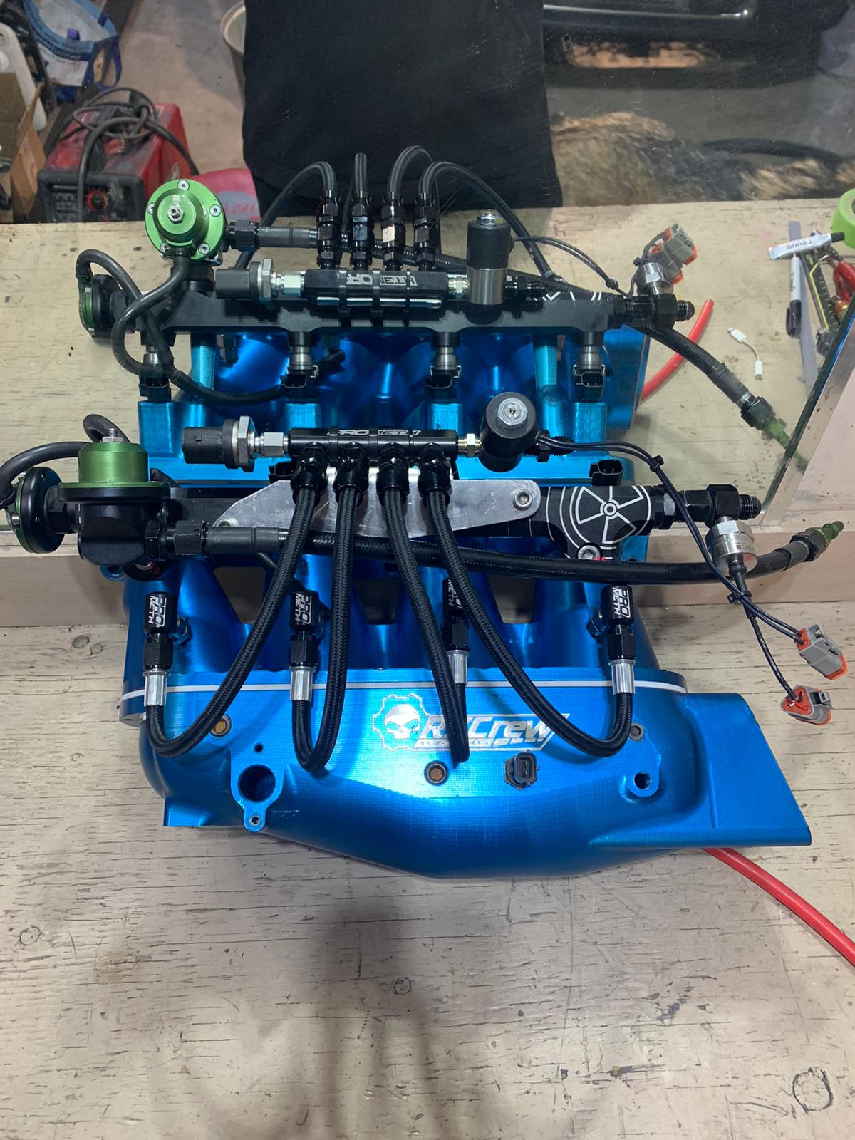

Here is a 'ghetto' set up doing with just control by Syvecs S7 ECU.
There are many ways to do WMI so if anyone is interested and does not want to do it themselves etc hit up the squirting specialist 8-)
Ghetto set up 1.jpeg (266.76 KiB) Viewed 263790 times
Ghetto set up 2.jpeg (130.15 KiB) Viewed 263790 times
