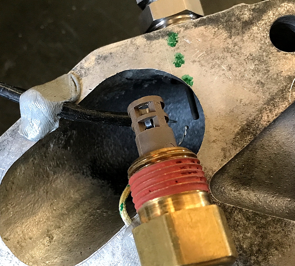

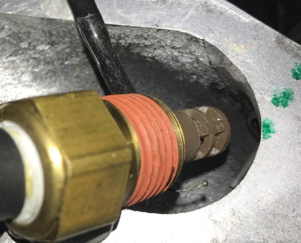

Here is close up shot of sensors:
  • Fast Acting ACT
  • Type K Fine wire 0.3mm diameter wire
  • Type K Fine wire 0.5mm diameter wire
  • Type K Don Mega EGT Probe

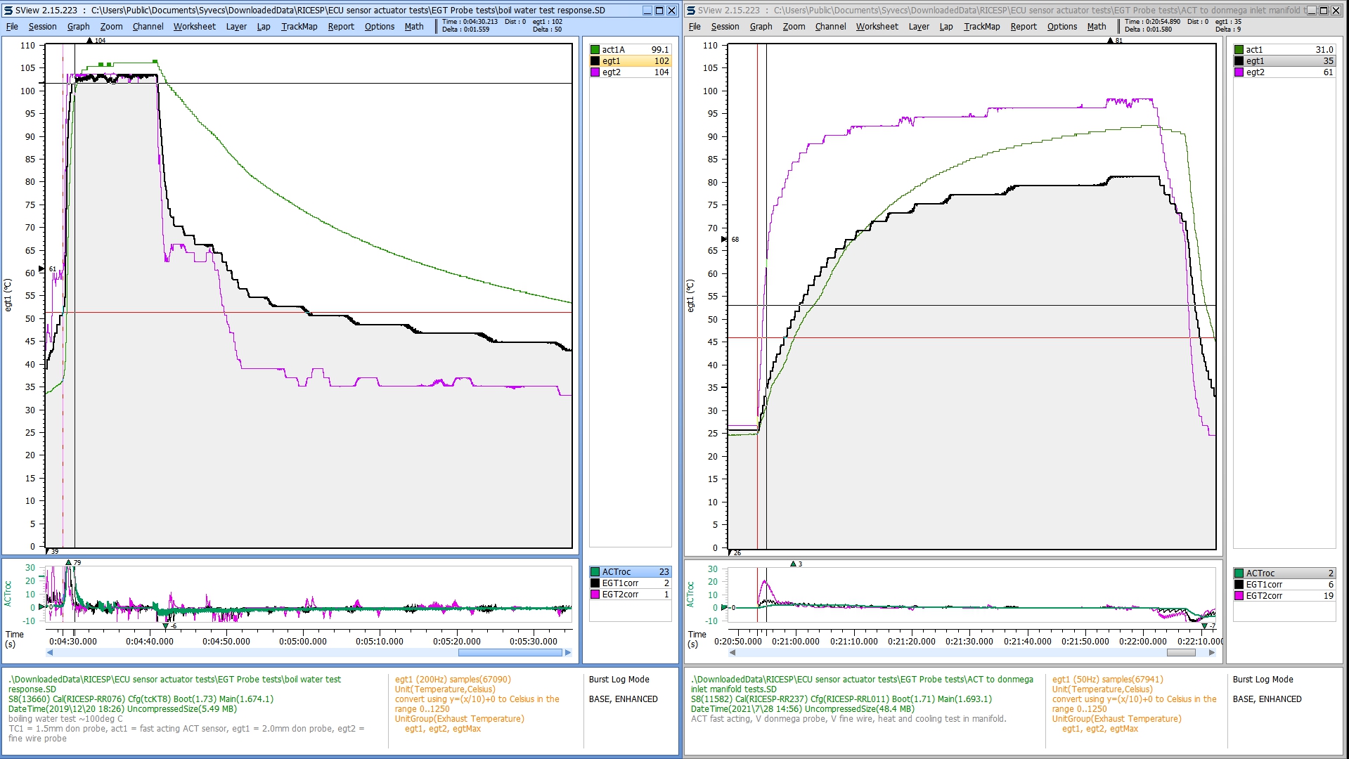

Below is the test conducted in boiling water (fast acting ACT still using default calibration linearization) so ultimate reading was incorrect! but the response is what is important to understand. The later log Syvecs implemented the ability to calibrate the onboard EGT inputs, so these were set up with the Omega simulator in the latest log as well. Any offset to temperatures are a function of the various probe characteristics rather than instrumentation deficiency.
Sampled after ~1.5 seconds exposed to majority temp input.
Obviously in an engine the thing is used to read air (and fuel) mixtures, and the mass flows are much higher than simple heat gun test on bench, however you can see that there is a large transient delay and offset to real temperatures (once calibrated correctly).
Anyway somewhere between these two extremes is what to expect in reality, either way a don mega probe can be used to sample gases is the main point, and it wont melt either :lol: + be allot more durable too.

purple is your probe, black is what ?
stevieturbo wrote: Thu Jul 29, 2021 10:04 am purple is your probe, black is what ?
*as per comments in left log file*
purple = 0.5mm diameter wire K type
black = 2.0mm tip diameter Donmega probe

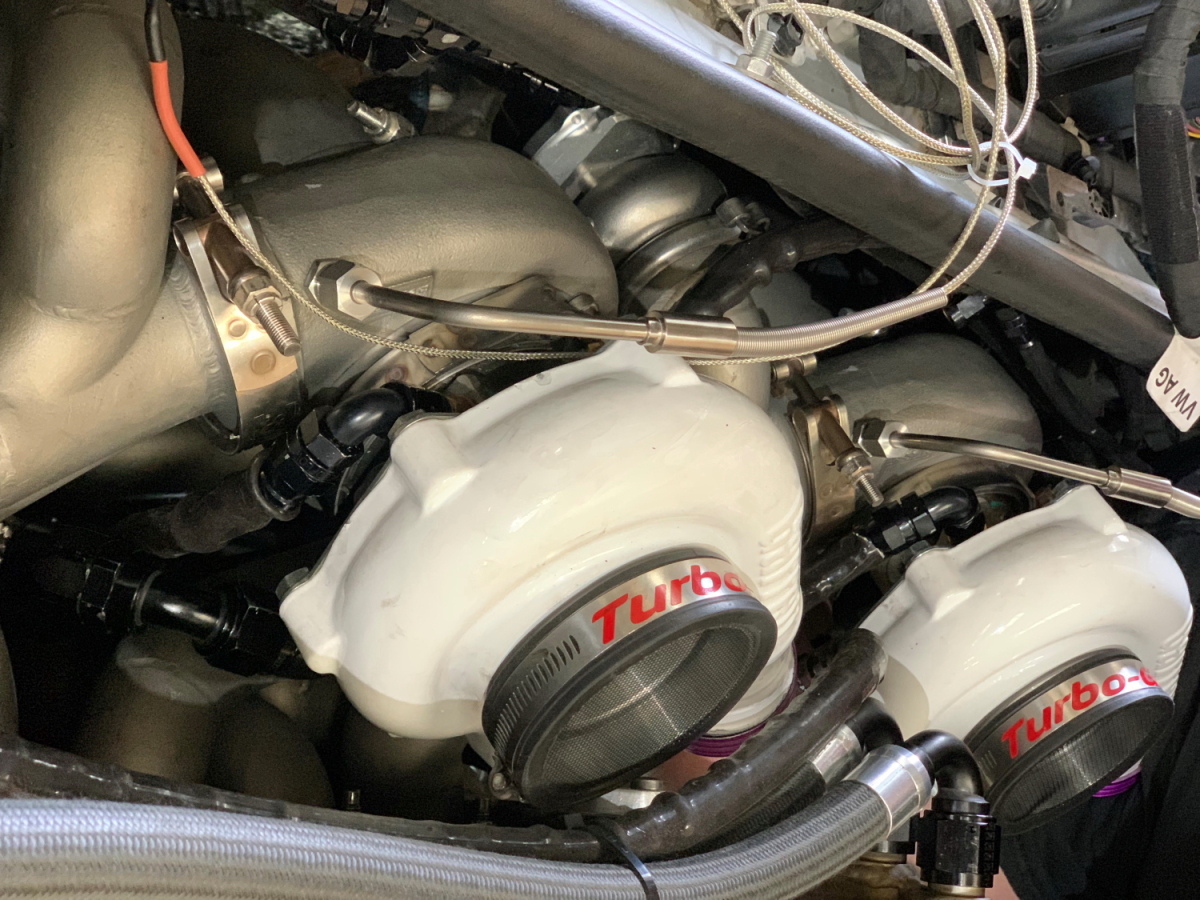

RICE RACING wrote: Sun Jul 18, 2021 9:40 am Another nice instal of the donmega probes

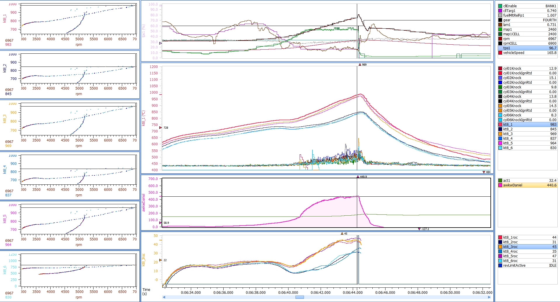

Here is a bit of information showing temperatures on the above engine
VR6 T.jpg (872.9 KiB) Viewed 41006 times

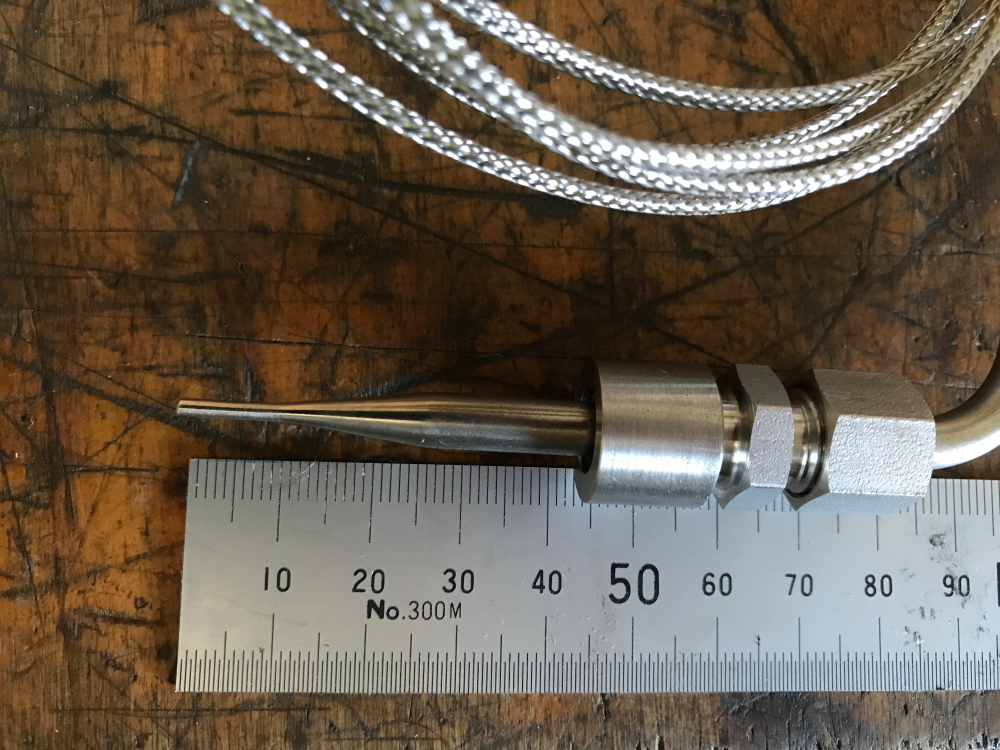

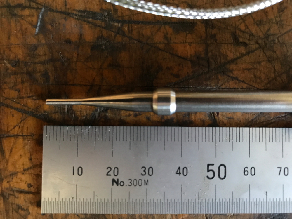

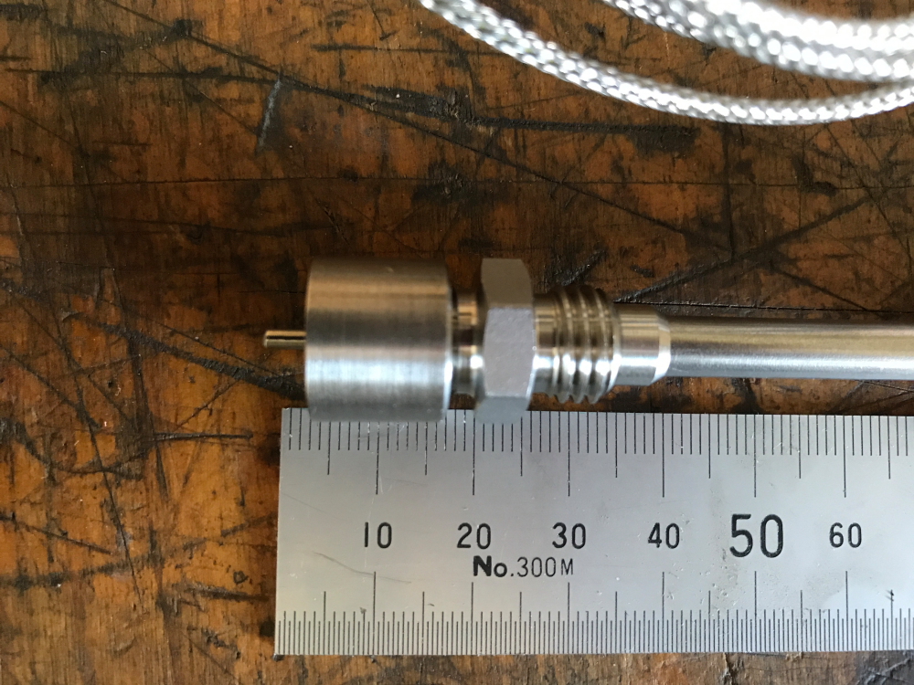

This may be of use to some people, this is the specification for height setting range on the donmega probe/s.

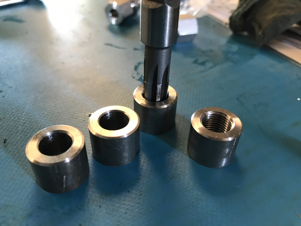

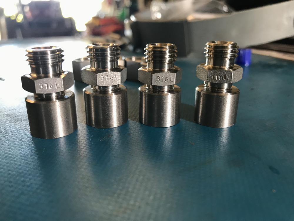

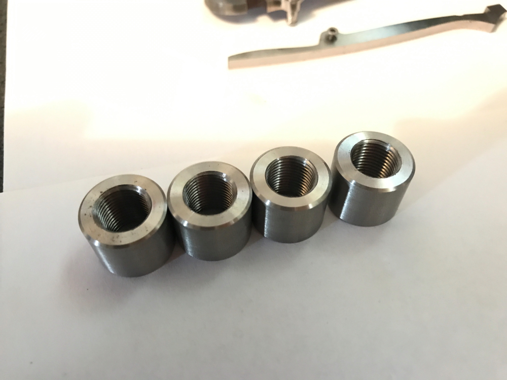

Bosses pictured I had to make cause ones bought off internet are shit so customer molested the holders threads and all were different heights, threads loose etc :roll: make sure a proper machinist does these for you please. Drilled, taper reamed, then hand taped! to correct fit so the adaptor just is near bottoming is the correct *only* way it gives a full lock on the thread and is leak/stress free. Picture of proper anti seize is included for reference as well.
As above cont...
