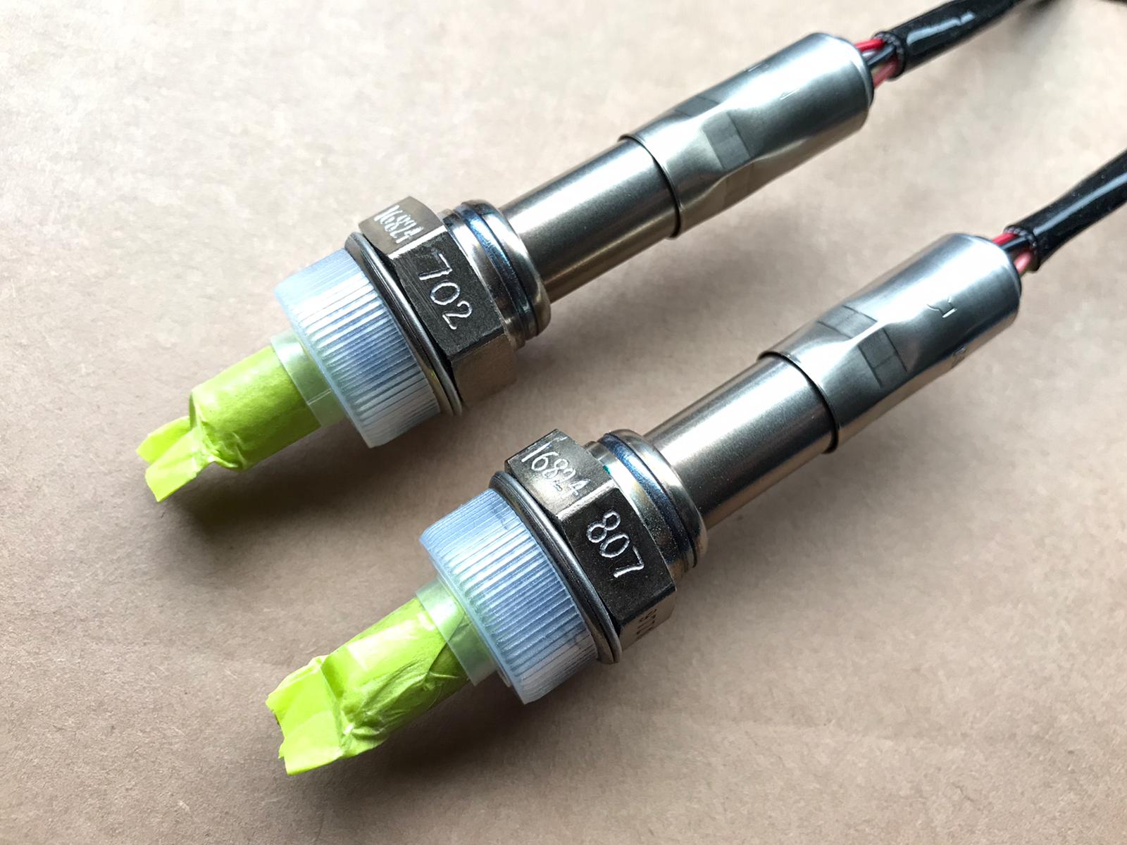

stay tuned.............. brand new 2 x of these bad boys :shock:
DONMEGA LEB GRADE LR NTKs.jpg (562.54 KiB) Viewed 141007 times
FUN FACT: I ran these sensors 20 years ago, and to revisit will calibrate and offer Life Racing L1H1 curves for those who are after the best on Petrol/Gasoline applications which can be plugged into our Lambda to Can unit or any Syvecs/LR ECU

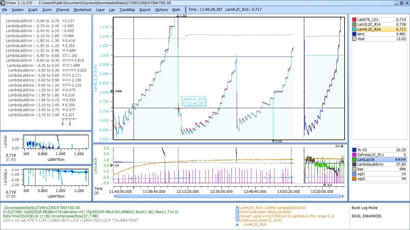

so for those interested as I do get calls about the 'motorsport' grade NTK sensor, here you go !
as per log notes in log file, two different brand new sensors run with the supplied curve to match this sensor
moral is.......
donmega is a must if you want spot on readings in all ranges (they do read ok between 0.8L and 1.0L which is 'normal' mixture settings for most engines), and every sensor as always is different unless you have something really rare/exotic like a pair of brand new TAG Electronics NTK's like I have :-)
If you want spot on sensors (for extreme rich or lean operation) send them in to be calibrated, regardless of the type I can accommodate you

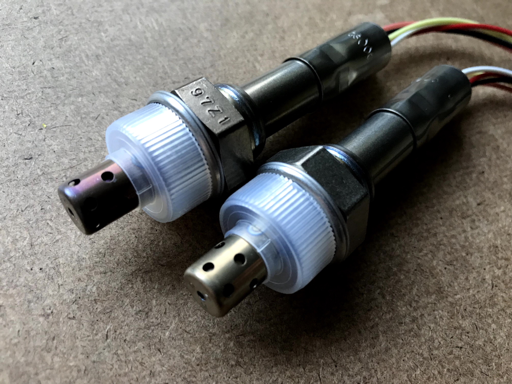

and motorsport 'L1H1' LR NTK done better, fully corrected per sensor, serial numbered, ready for action !
