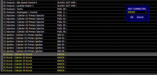

Can anyone guide me on how to assign my knock sensors to their respective cylinders? I've searched this forum for the topic, searched the manual and watched the Syvecs Help video on Knock Control, but I think I'm missing something.
This is with a S6 Plus and firmware version 1.84.

This is for a 6 cylinder 2jzgte (in-line six). Knock 1 is between cylinders 1 and 2 and Knock 2 is between cylinders 5 and 6.
If you noticed in the photo i attached in my original post, the I/O configuration setup doesn't allow me to choose between Knock 1 or 2 when trying to assign a knock input to a specific cylinder. The only choices I have are "not connected" or "knock".

Update from Syvecs Tech Support:
"Just assigned to knock. There is a multiplexer inside that takes care of the signals."

Received a response from Syvecs Help for this question:
"Just assigned to Knock
There is a multiplexer inside that takes care of the signals" - Ryan
