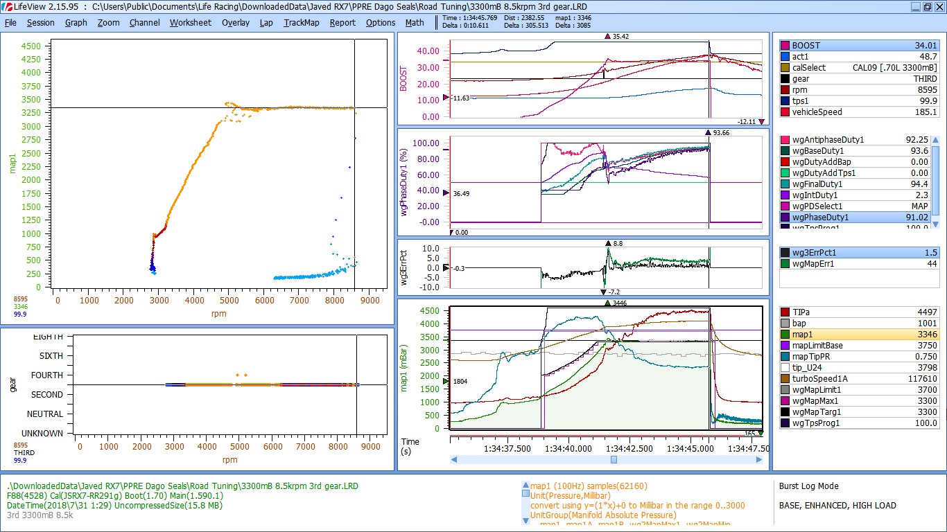

mine works quite well. even with my lack of fine tuning. 10 psi springs,iwg75's efr7163's x 2 ~1000hp at wheels. vq35hr. have been up to 35 psi with room to go higher. i used 4 old apexi smc mac style valves. (changing to perrin bullet valve units)
4 ports do work, but i have found that they have a very narrow window. ie :10-20% duty range between lowest boost and maximum boost. (your fine tuning in closed loop has to be on point to make them work, and you cant tailor they way it works re: phase vs anti phase duty curves.
basically you kind of want to be able to manipulate the way each valve is driven independently to compensate for system characteristics.
