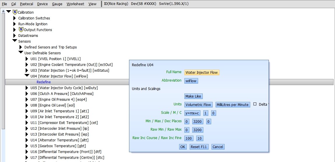

Yes :)
See below.
example of user defined sensor
Les Beane.jpg (268.49 KiB) Viewed 28179 times

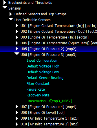

i only see these options the calibrate the sensor ....
Re: Creat own "Sensor"
Type
V (view)
C (customizing options)
You will then see the table I posted,under sensors, user definable sensors.
