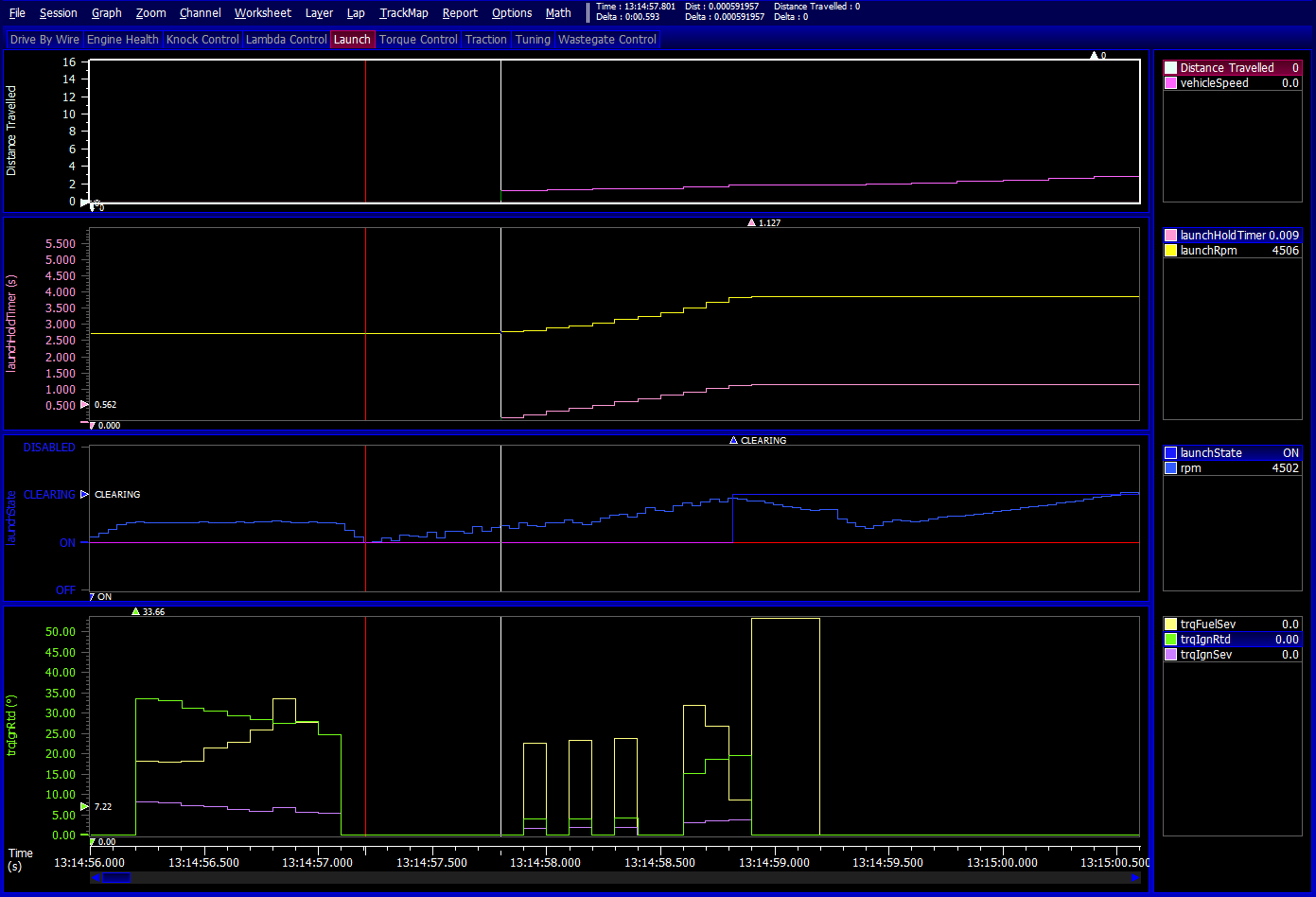

The reason your activation speed is set so low is to try and overcome the delay the occurs due to the speed converter fitted on your car. When we initially set it up at Combe in 2014 that was causing a problem with prompt activation of the launch hold timer, in the end I reduced the number of speed pulses used to calculate the vehicle speed to just 1, as it was already being averaged by your converter. Before we did that the first speed update was taking 0.55seconds to reach the launch strategy after you had already set off.
The launch exit speed is the trigger that takes out of "stationary launch mode" (my term) and starts the hold timer going. While you're within the launch hold phase, the launch limiter is applied using the "Launch Control/Base Engine Speed" map which is RPM vs hold timer(s). The launch hold timer has a max value set in "Launch Control/Launch Hold Time" and once the hold timer reaches this value you are out of the hold phase, and into the exit phase. The launnch exit phase lasts as long as the time set in "Launch Control/Launch Exit Time" which is currently 0 on your car, but can be used to set launch specific boost target limitation and/or nitrous duty adjustment.
You can see all this happen in the screenshot of your log below Since 2014 Syvecs firmware has improved massively in this regard, and I've improved what I do with it too. With your car we still have the problem of it being 4wd and spinning all 4 wheels, so the launch hold time is the way to go (with Syvecs). I would recommend you look at updating the firmware to add the Stage and Launch individual phases, and I would also work on using more retard and less cut. You're cut tables already do this to an extent but with more tuning it can be improved.
Looking at some more of your original logs, we could speed up the vehicle speed logging to test, but on launch it pops up immediately to about 20km/h so you could raise the 1.6km/h exit thresholds to a more normal 10km/h. This means that if you creep in staging while launch is active (unlikely on in a sprint/hc event) you don't trigger the launch hold timer.
