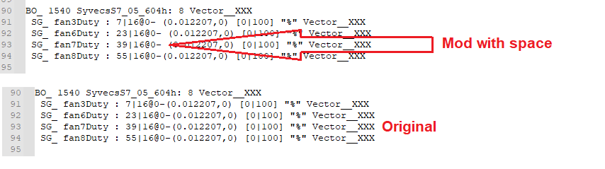

Struggling importing into AIM RS3!?
Re: S7-I and S7Plus Can1 Fixed Datastream - DBC
The file reads OK into Kvaser Database Editor so it is probably something in the signals section that the AIM software doesn't like - perhaps one to take up with AIM since that error message isn't very helpful?
Post by littlefella »
I had the same issue with Cosworth ICD. Fortunately you get a message of the error. There is an error with the compilation of the DBC file it seems. There is a space missing between the sign for Data Type (+ or-) and the Maths sector of the config as in the attached screenshot. You need to correct every channel.. Note. on line 94 on the top corrected channels you will see below the arrow the space is missing there also. so the file would fail at this point. Checked imports OK.
cheers.

Updated original post with tweaked DBC

littlefella wrote: Mon Apr 18, 2022 8:42 am I had the same issue with Cosworth ICD. Fortunately you get a message of the error. There is an error with the compilation of the DBC file it seems. There is a space missing between the sign for Data Type (+ or-) and the Maths sector of the config as in the attached screenshot. You need to correct every channel.. Note. on line 94 on the top corrected channels you will see below the arrow the space is missing there also. so the file would fail at this point. Checked imports OK.
cheers.
Thanks!
