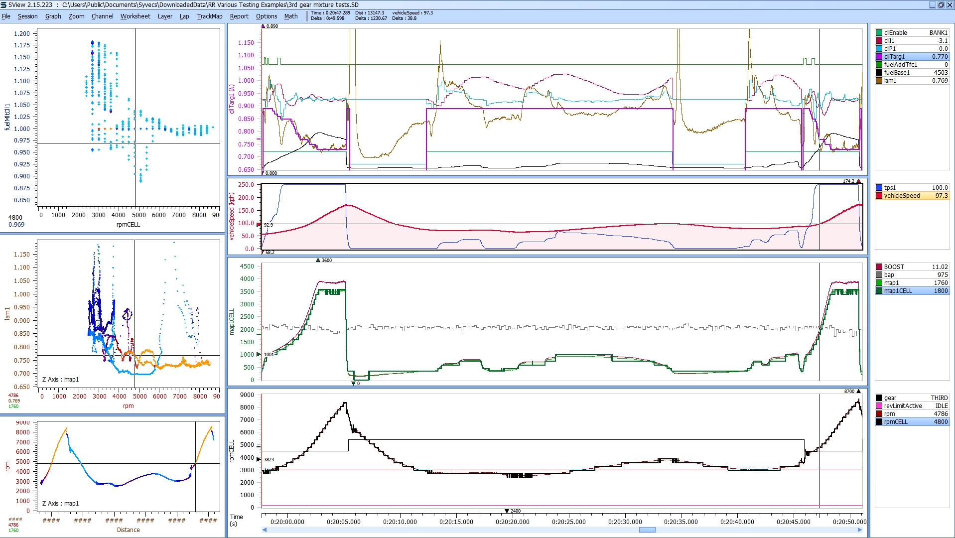

Here is an example of it not changing regardless of what rpm you WOT from,
Same gear, same end rpm, one starts at 3300rpm other 4800rpm.
If you are more specific then can suggest what to look at but suffice that there is a stack of things to look at which would influence it and cause you to have different readings.

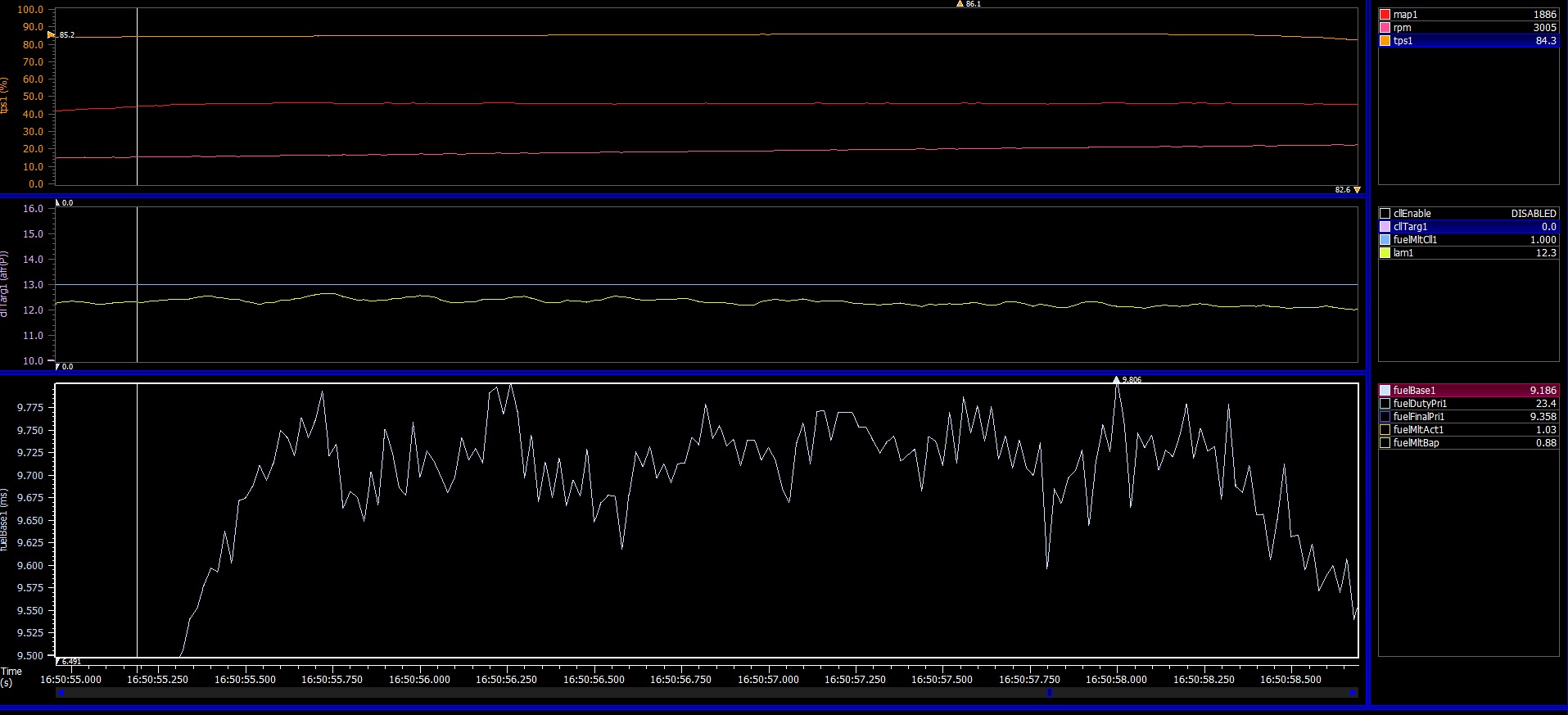

Although an extreme representation...fuel base is also fairly up/down for the area shown....so whatever mapping is in those cells could be smoothed a little ?
logger RPM is very stable, logged MAP is very stable...so why is fuel base a little up/down ?
