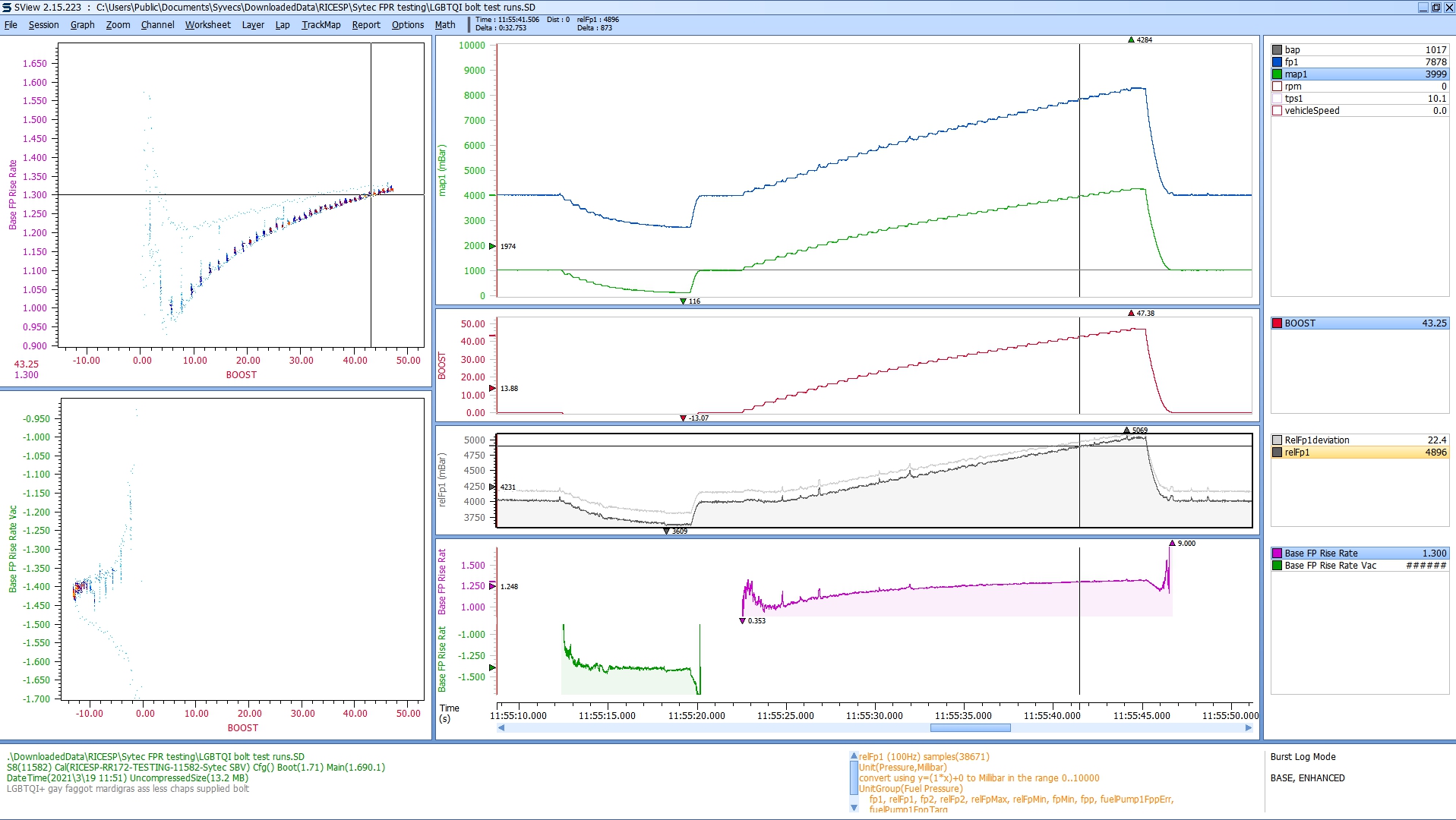

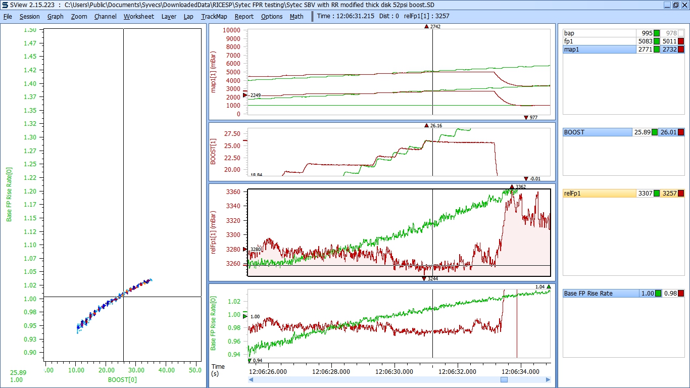

As delivered in red (below 1:1 rate), V mild clean up of disk once I understood the problem of why it did not work as claimed.
below 1:1 rate at ~2700mB map
RR disk mod v stock.jpg (452.96 KiB) Viewed 52736 times

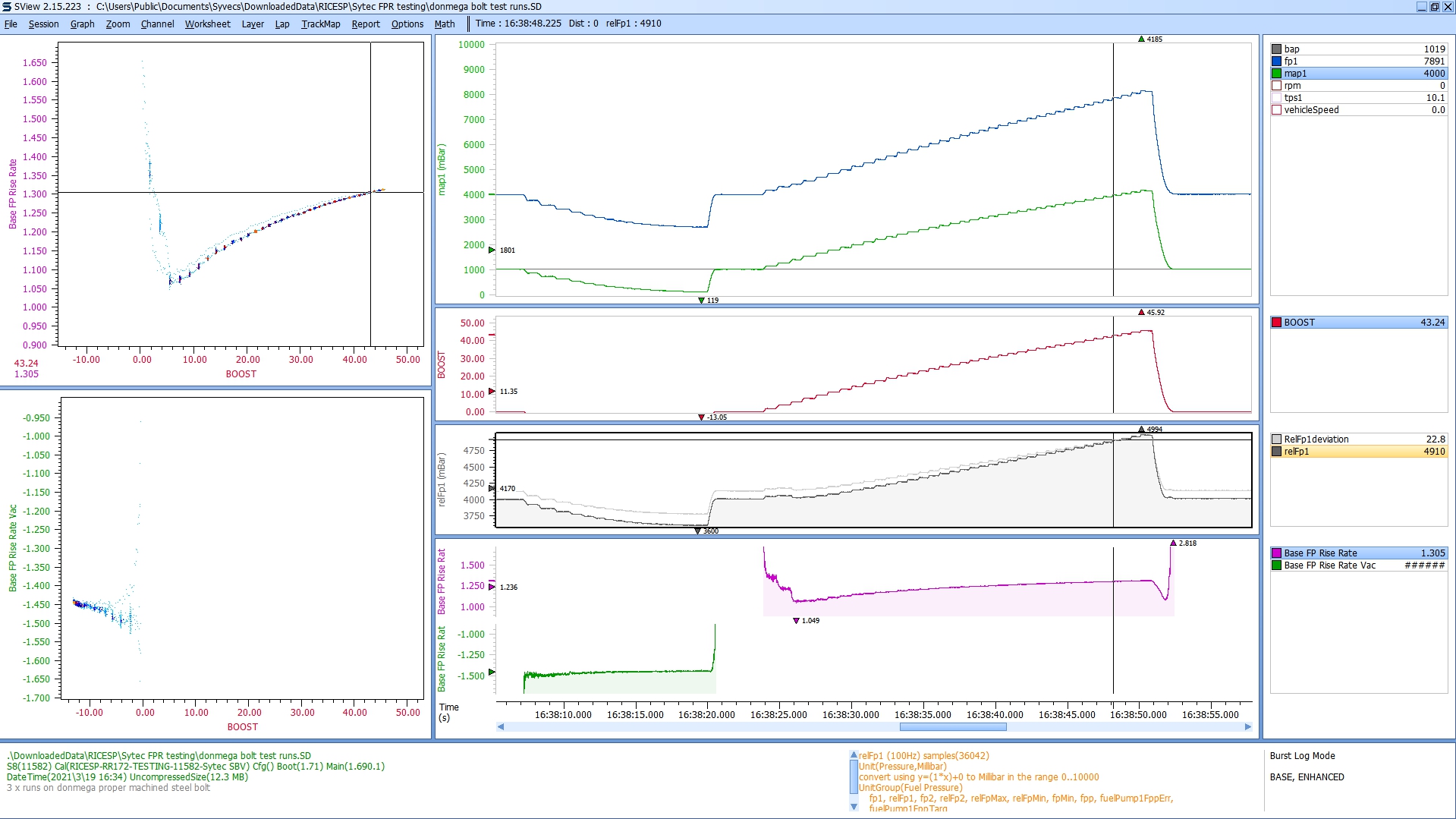

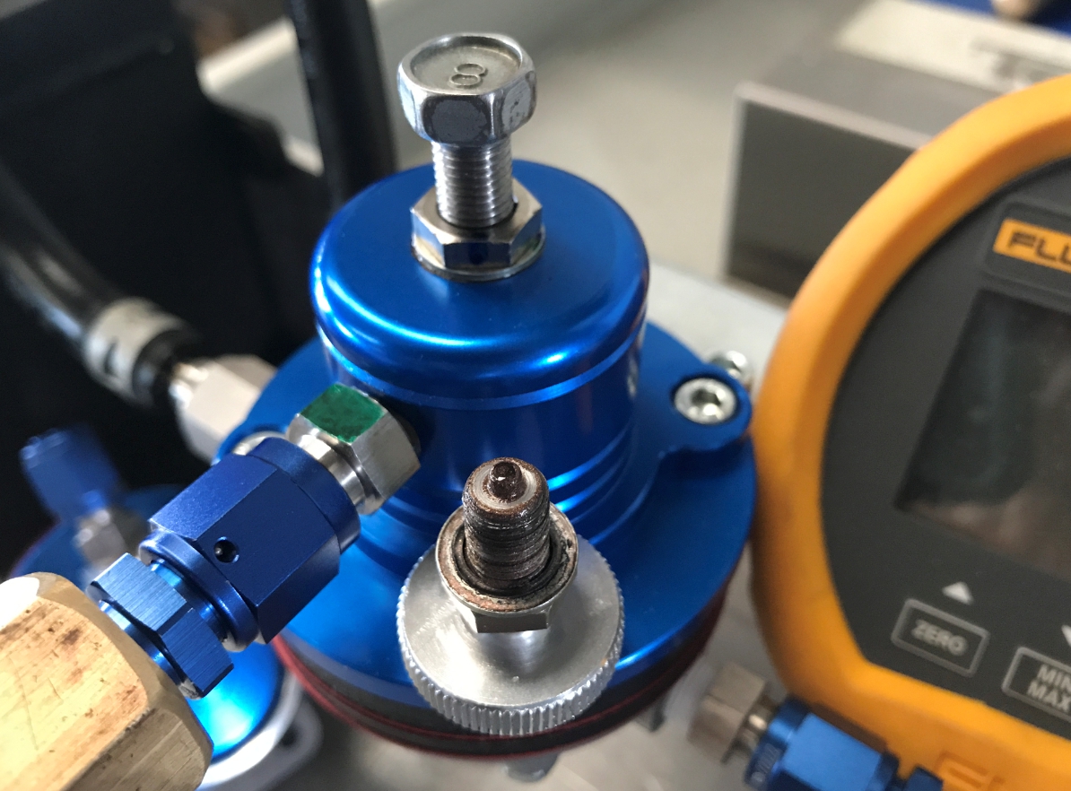

These are pictures for those who don't like video (everyone is different).
Amazing to see that a 'bolt' can have this much effect !
I changed the material and profile specifications of the nipple on end, its all these little details and ability to test effects that add up.
pretty shit.jpg (657.95 KiB) Viewed 52709 times
proper not shit.jpg (633.53 KiB) Viewed 52709 times
