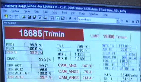

2 decades ago we were setting up some engines running on methanol with 35% nitro methane, there was no requirement to know nor did anyone need to know what the stoich AFR was for that specific fuel, the owners did not understand Lambda had no feeling for it, but they knew AFRp scales well, so gave them guidance based off that. Just as you say Lambda is independent so too is AFRp, metric or imperial tape measure, same deal.
I personally get a hard on for equivalence ratio, it makes much more sense than anything else does since were talking in fuel terms NOT air! Remember you are adjusting a fuel table not a farking air table :lol: if you doubt me go look at any Syvecs map, running 42.9% excess fuel has meaning, 0.700 Lambada does not to 99.9% of tunas, they may say on camera that they understand it, but you can always see them fark it up when applying percentages of corrections based on difference to target... IE: they have no idea lambda really is a shit way to look at things, super miss understood, and has zero common sense for doing fuel adjustments, its basically useless IMHO. It is much better to talk in fuel terms rather than air, and you can see instantly without needing to do maths in your head and fuck it up that its got more or less fuel than required and how much it is, simple, yet no talking heads every mention it :roll: Little side note, go look at old papers they are written commonly in FAR < fuel terms :) maybe people were smarter back then? either way which ever kunt made L the prominent unit needs a good swift kick in the nut sack, same for the arse clown that thought it was a good idea to mix imperial and metric units for tires size designations :roll:

Re: Lambda to afr
Equivalence Ratio example
13% to 15% excess fuel, again makes allot more sense and is the simplest to use too.
EQR 1.jpg (133.06 KiB) Viewed 54369 times
Re: Lambda to afr
Isn't that showing lambda, as "mix"?
Re: Lambda to afr
TimH wrote: Mon Jul 19, 2021 10:05 am Isn't that showing lambda, as "mix"?
Nah, frogs love to talk in equivalence ratio.
0.870L to 0.885L is about right for a maximum power setting.
