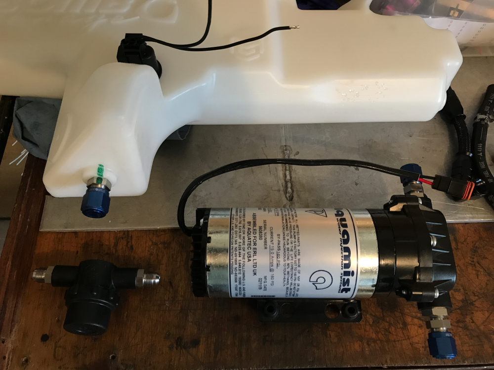

Great start Ryan.
In total agreement on lines, we actually use AN6 PTFE stuff as pictured below.
Its important to use this size on inlet and exit as over a length of install on a normal car all of the fittings and line routing adds up to a loss of effective flow rate from what is on the sticker of the pump people choose to run.
The pictured inlet from filter is 'over size' and stainless inner so compatible with 'meth'.
WMI parts4.JPG (603.01 KiB) Viewed 64496 times
WMI parts1.JPG (683.88 KiB) Viewed 64496 times
WMI parts3.JPG (620.8 KiB) Viewed 64496 times

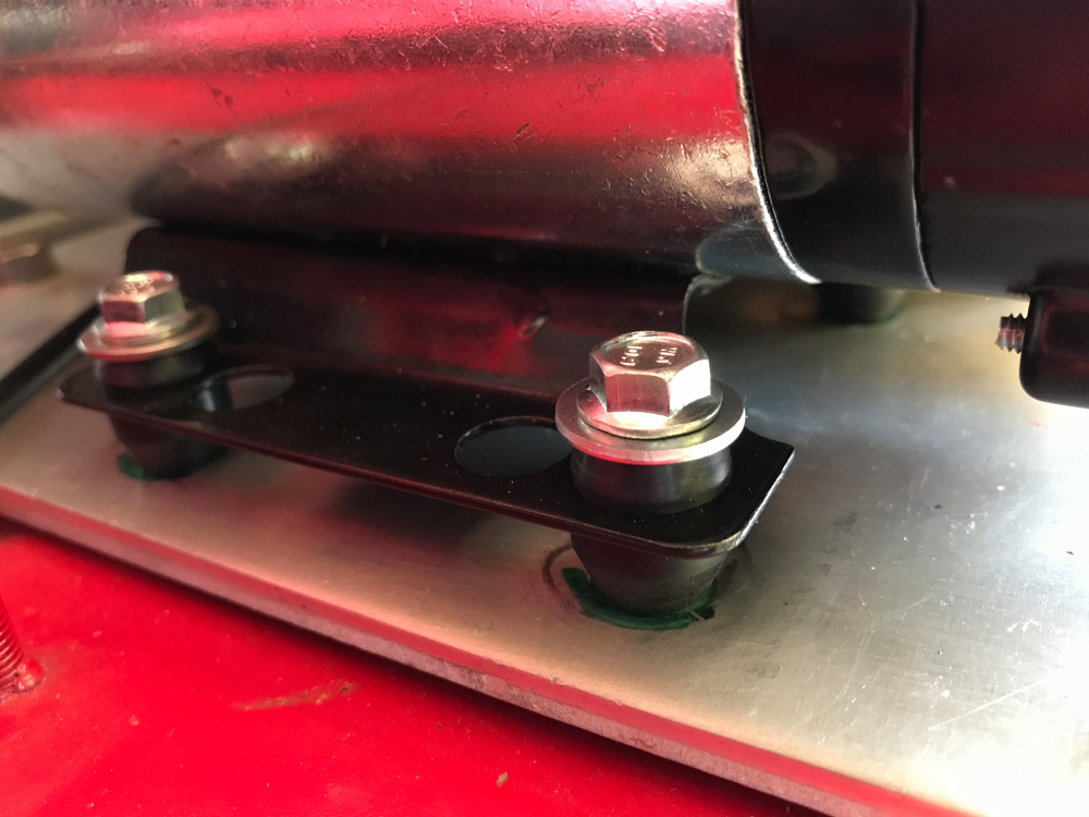

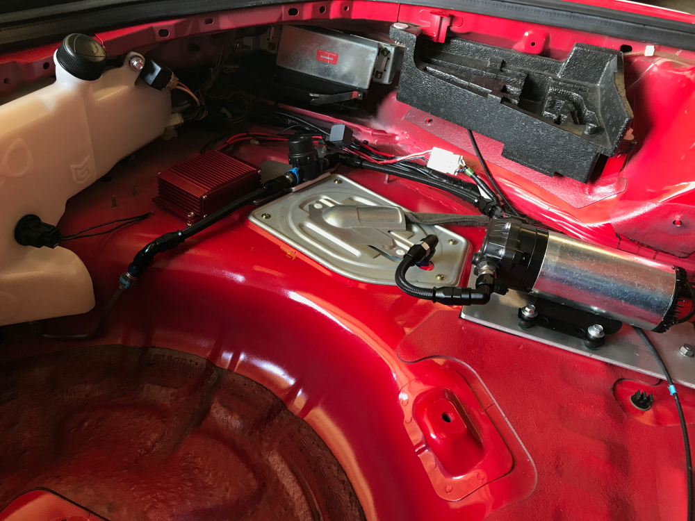

Re: Recommended Parts for Water Meth Injection setups
These pumps have allot of hydraulic hammer to them so good mounting and preferably inside is best generally intolerant to 'weather' but some people do pull them apart and seal with silicone, or put a jacket around it however internal mounting is good if you have the space, don't over clamp down on the rubber mounts, you have to allow it to wiggle in operation, and as stated this is more in check once you get the pulsations under control.
Mounting like so as a guide.
WMI parts5.JPG (743.16 KiB) Viewed 64496 times

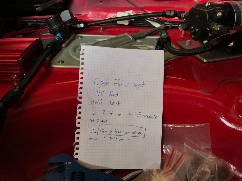

Mount like this, plenty of compliance in rubber bushings, loctite threads.
Open flow checks.
WMI parts3.JPG (595.85 KiB) Viewed 64495 times
WMI parts2.JPG (643.53 KiB) Viewed 64495 times
WMI parts1.JPG (547.53 KiB) Viewed 64495 times
