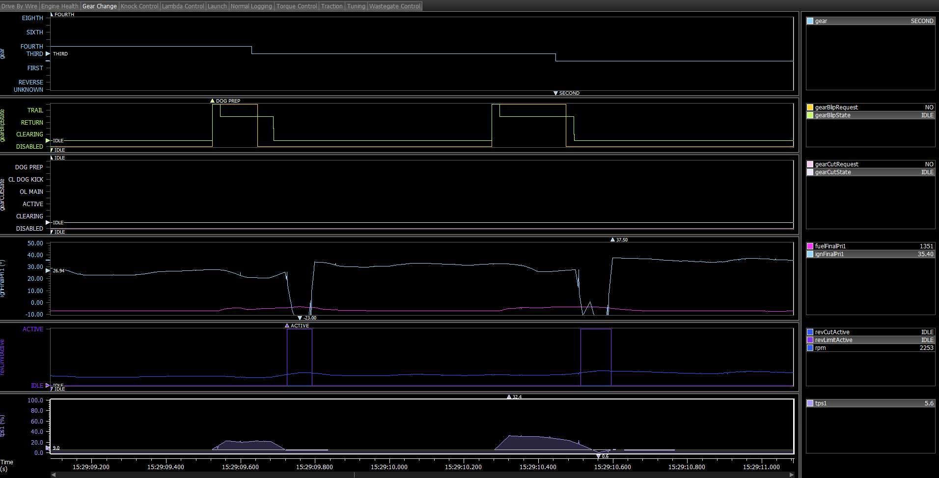

here is a log of a down change, you can see the throttle opening rpm does increase, whats odd is that i get a rev limit kick in and hold the rpm but it looks like the gear change is complete, maybe this is why the change feels so harsh?

And if you are talking about a rev limit...highlight it to see what rev limit is active.

so the the rev limit is the rev hold time after completion, i can see this is too long, i will have a play and see if i can smooth this out
