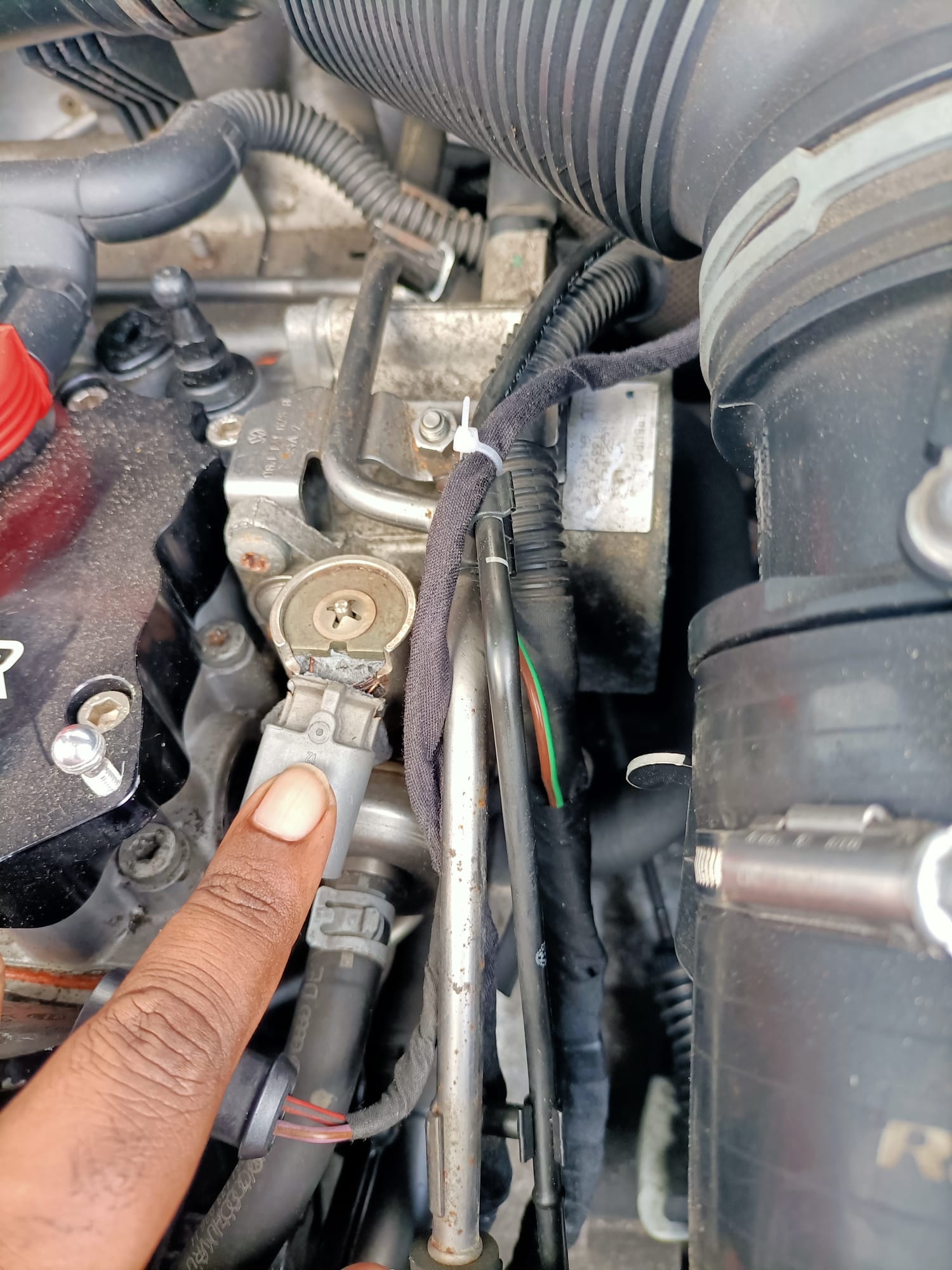

Hey im running the SGDI-TSI on a Passat CC 2.0 CAWB
I am having trouble with the DI pump using the basemap sent by syvecs I get a very lumpy start up with DI pressure max when driven at 0%
and if running in that state for around 5 mins the DI pump overheats resulting in alot of smoke and plastic burning smell and the connector no longer attached to the DI pump see picture attached

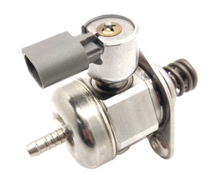

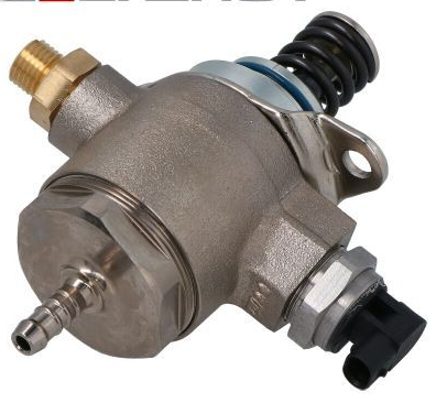

CAWA CAWB Came with a different Fuel pump to CCTA CCZA CCZB
open pump looks like this used in the CAWA and CAWB engines pump part number: 06H127025N closed pump looks like this used in the CCTA CCZA CCZB engines pump part number: 06J127025L:
running the basemap that comes with the plug and play kit on the CAWA CAWB engine codes with the Open Pump will cause the fuel pump to overheat and if left for long enough cause a fire
