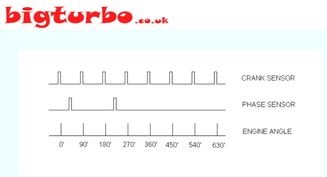

a scope trace with crank, cam and cyl1 pressure is handy so all trigger points can be referenced properly.
Although this from bigturbo.co.uk gives some idea where cyl1 sits in relation to the triggers.
