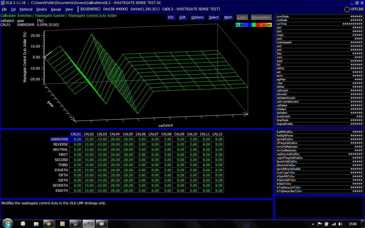

I've set the base wastegate duty table to 50% everywhere. I've then turned off the closed loop feedback by setting the wastegate integrator gain to 0% across the range and setting the manifold pressure error demand table to 0% everywhere.
I've then set the wastegate control duty adder as follows:-
Pos 1 = 0%
Pos 2 = +10%
Pos 3 = -10%
Pos 4 = +20%
Pos 5 = -20%

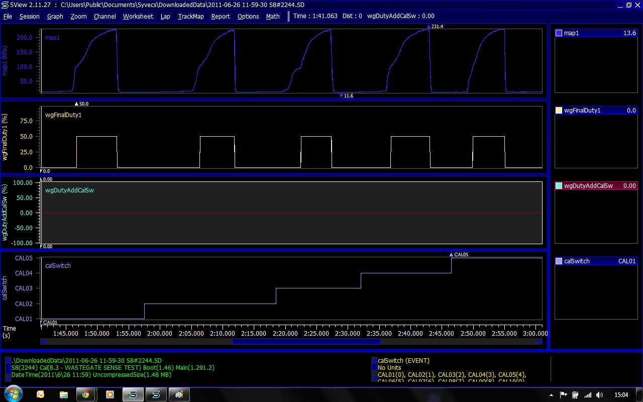

During an outing, I've then done a run at pos 1 at max load, then backed off and switched to pos 2 and gone to max load, then backed off and gone to pos 3 and gone to max load, etc etc. I was expecting to see that as I incremented through each position I would see differing max MAPs. I could then use the information to correctly setup the wastegate duty table.
However, the final duty for all five runs is 50%. It appears that the wastegate control duty adder isn't doing anything. :?
I've attached a screen grabs of the calibration showing the wastegate control duty adder settings and the logged data. If anyone could explain what's going on here, I'd be really grateful.

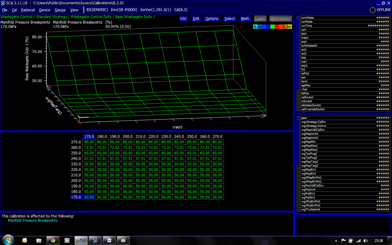

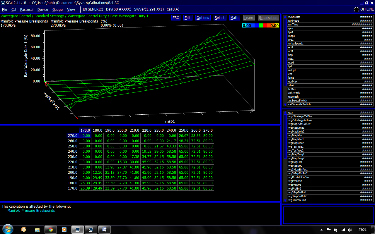

I looked at the base wastegate duty table and saw that it was basically set to crack up the duty to 80% (which relates to the max MAP target I'm looking for). As you mention, I then reset the table to hold the solenoid closed until the MAP approached the MAPtarget.
However what I found was that the MAP undershot the target by about 100kPa.
Looking into why, it appears that the wgFinalDuty was held at 0%, so I figured it could be that the polarity of the wastegate is incorrect and 0% is fully open.
I thought an easy test would be to turn off the closed loop control and then add to the duty by +/- 10% then 20%, but then obviously saw that it wasn't adding anything to the duty. :?

Well the first thing you need to check is that you phase duty table is how you want it. I would guess that it currently is backwards which is used if you plumb the valve differently.
Your base WG duty table should be higher where the boost is below target and lower where the boost is above target. Although if your WG is pretty good your try of starting it with a slope in the Y axis is a okay start. BUt to get the control better you will want to adjust the shape of the table. The default PD table can produce odd results if you have fluctuations in MAP.
On the S8 only, the PD table (Manifold Pressure error demand) is backwards, I don't know why!
To do what you want, you should put WG values in different boost targets, and use the cal switch to change the target boost. If you use boost targets that match the rows in the WG base duty table you will get where you want to be.
To "correct" the operation of the valve, go to Standard Strategy\Output Linerisations\PWM Output Linearisation and set it to 0=0% and 100=100%

As I suspected the base wastegate duty table was the wrong way around. 0% = Fully open, 100% = Fully closed.

I've also gotten to the bottom of the reason why the cal switch duty adder appeared not to be working. The wastegate control duty adder only affects the OLD LMP strategy base duty default. 8-)
