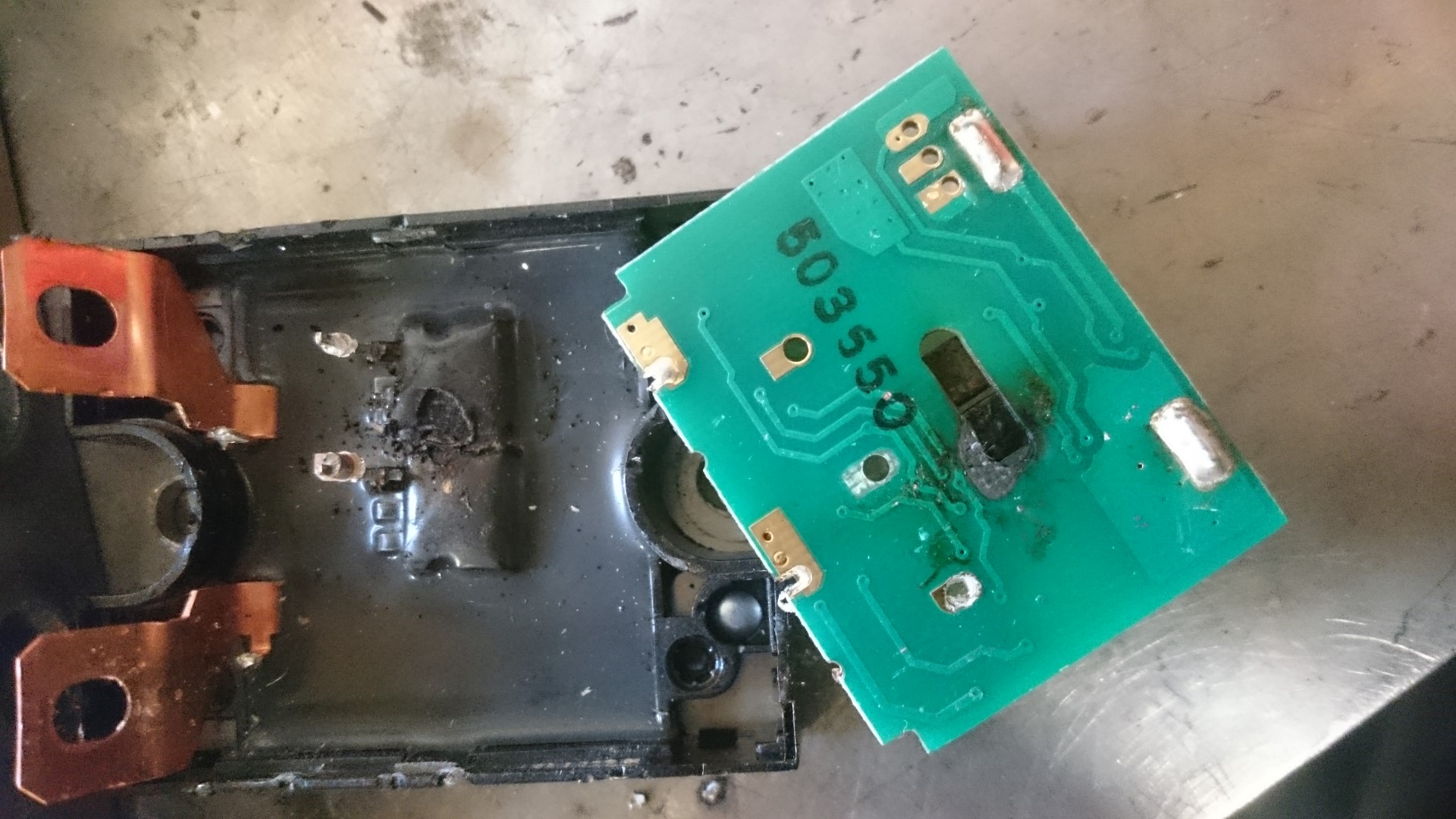

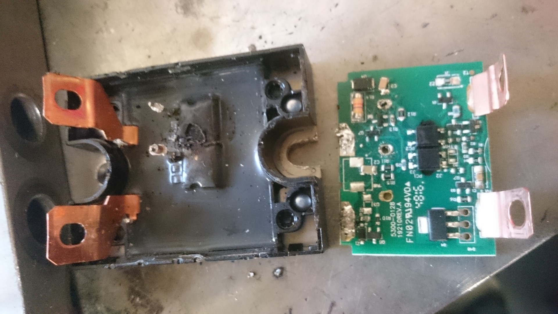

Out of interest....how did you kill them ?
I killed one myself, but pretty sure it was a wiring short the way I soldered them onto the diode for convenience then heat shrinked them.....and the heat was a little too much for the wiring sheath and as I crossed the wires over each other, pretty sure they shorted at some point. lol
Mine went up in lots of smoke, raging as it was a proper Crydom one, not even a cheapy ! lol
Given the actual load through the flyback diode would be veyr small...I dont think it would need a huge diode ? I think mine was around a 5A piece.
Mine worked fine for initial testing, went for a drive and again all seemed well. Got home, turned the car off but the pumps stayed running, although definitely not at full power
It was during probing to find out WTF was going on the SSR went up in a cloud of smoke.

Did you heat-sink the SSR? at 60A, a 100A SSR will need a 1C/W heatseak to keep it cool and for it not to die.
I would have no hesitation in using a decent 100A SSR (e.g. Crydom) properly heatsunk, with catch diodes wired as per manufacturers recommendations. And if you can use the Syvecs software to limit the initial PWM so it soft starts (surely possible?) then even better.

I'm sure the failure was my own fault with the diode/heatshrink/wiring
I did not use any resistors etc, it all worked fine without them, and turned off ok during testing. SSR's seem to want the current to flow in one direction only too....ie the supply/load are fixed terminals, whereas with an old relay you can use either terminal.
