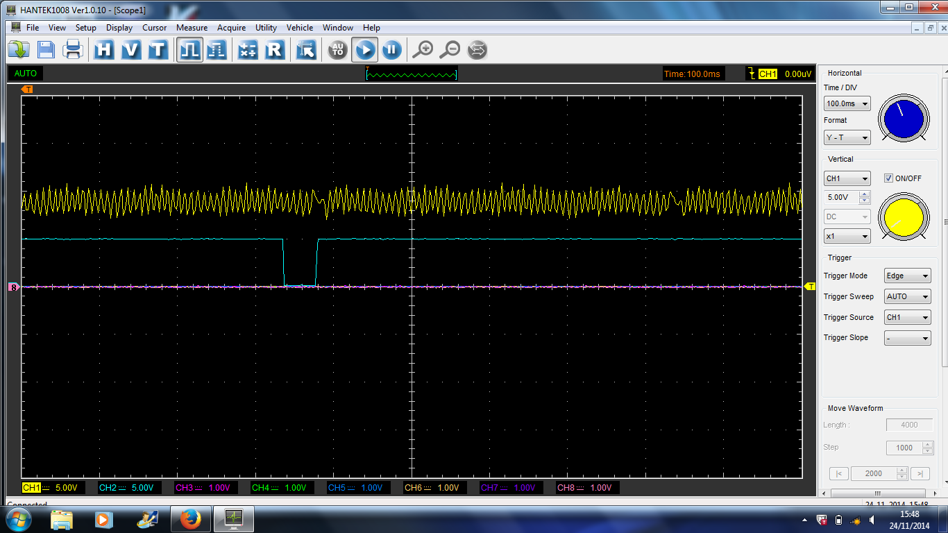

Thanks for the fast reply guys. I know i've got something wrong but cannot see it for looking.
I have attached a crank and cam trace of the signals recieved at the ECU pins. I have check the pin allocation angain and its right.

Not that it matters because you can trigger on a rising or falling edge but the crank sensor has the wrong polarity.
Anyway, I would really need to see the sync scope output to confirm the crank and cam are properly assigned.

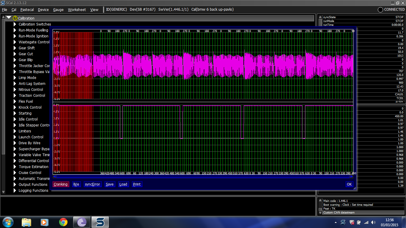

You absolutely need to provide a sync log from the ECU itself. Do you even know if it's getting then losing sync? The sync log will show you the exact point at which it's loosing sync, or the point it which it achieves 720 sync (full sequential ignition and fuel). Is the logging set to log regardless of RPM and TPS? If you set it to do that it will generate a lot of logging but tell you important information,

How do i get more inputs in the SyncLog? I thought it was only for cam and crank.
Here is the trace and print screen.
- BMW 6 csl.png (166.08 KiB) Viewed 44879 times
