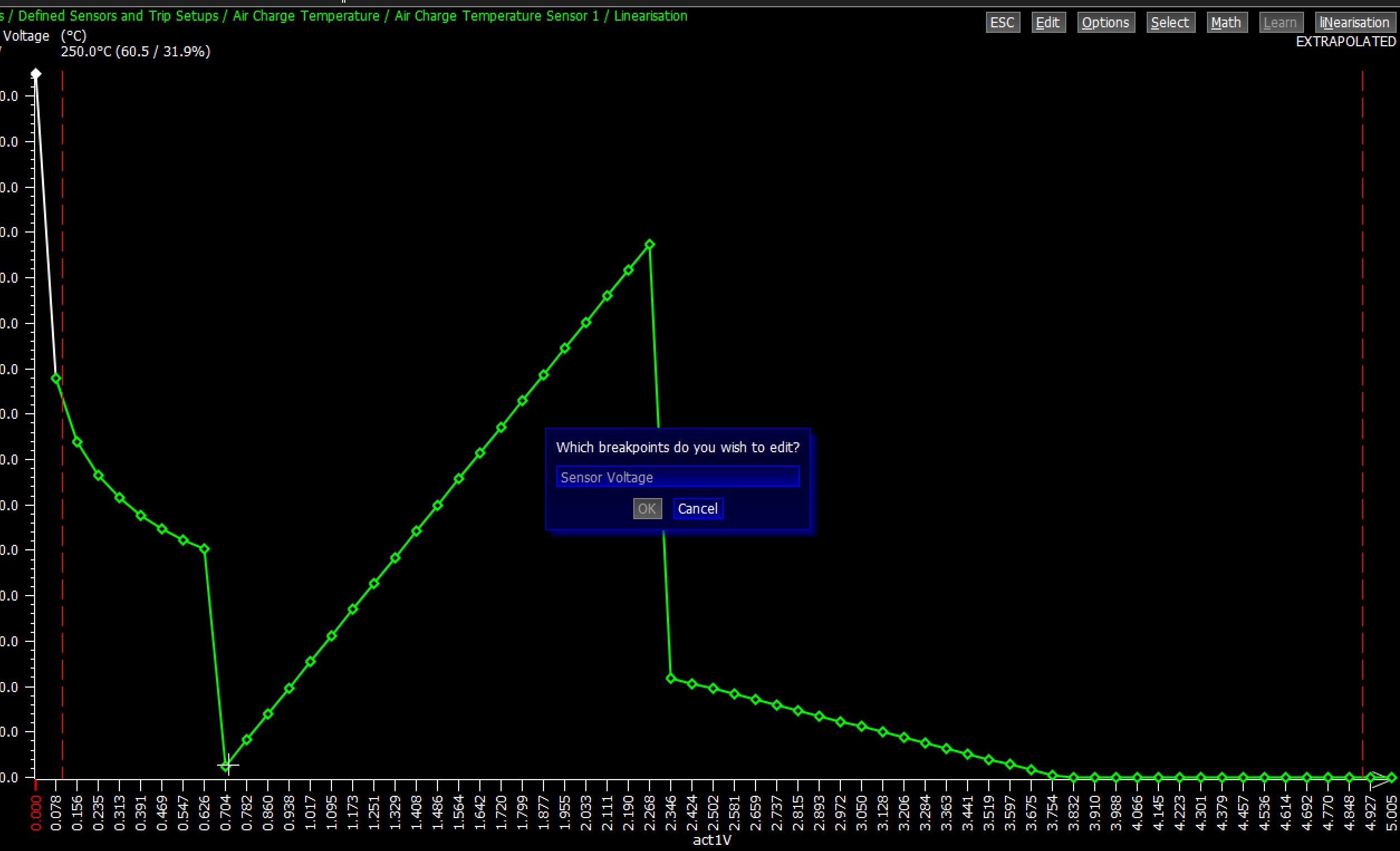

As per title - just inputting some linearization data for a temp sensor - the option to 'edit breakpoints' is there but the OK button is greyed out:
Any ideas?

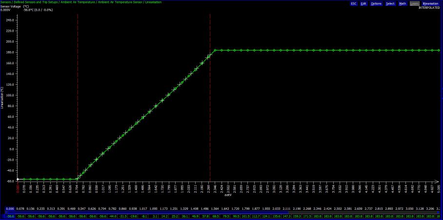

It was for my Autronic PTC air temp sensor:
Also set up my default low and high voltages - using Interpolated as the type I get something that looks like what I'm after:
