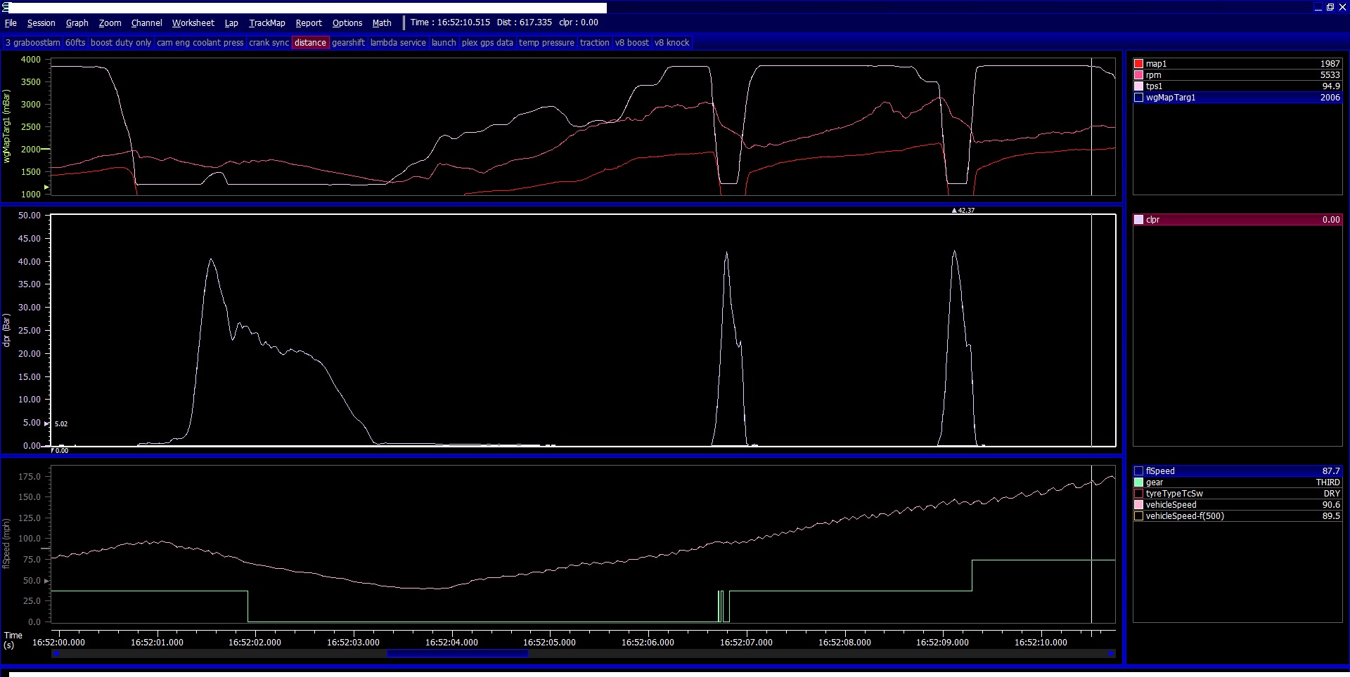

Short glimpse a section of a hillclimb, going 2-1 into a chicane, then 1-2, 2-3 so 3 clutch operations, logged at 50hz. Latter 2 approx 0.4s duration from rest to rest.
Most of the falling edge side of things would exhibit the little step on the way down. As to how far my diaphragm goes over centre etc...no idea.
Initial 2-1 downshift, clutch operation is much slower.
No flat shifting etc anywhere here
clpr graphs.jpg (284.59 KiB) Viewed 43431 times

Brilliant, thanks for sharing that buddy that shows it perfectly.
That's a lot more consistent than I thought it would be too, to be fair. The 2-1 being much slower than the 1-2 and 2-3 are still all within a reasonable range regarding peak pressures, I'm liking this idea again now. Interesting on the little blip bit on release, must be the pressure plate landing back on the friction disc?

Re: Flat Foot Shift RPM
You could use any manner of sensors on the pedal really, no reason why that couldnt be adapted.
I just used pressure because it was simple as my clutch is hydraulic. It's a 100bar KA sensor, but there are probably cheaper ones out there.
Like you with previous setups I'd microswitches then mucked about trying to get them to switch at the right time etc etc Just a PITA.
But the hydraulic can also give some indication of what's going on with the clutch vs just a simple pedal pot. Might not always understand what is going on...but I'm sure it is more useful.
