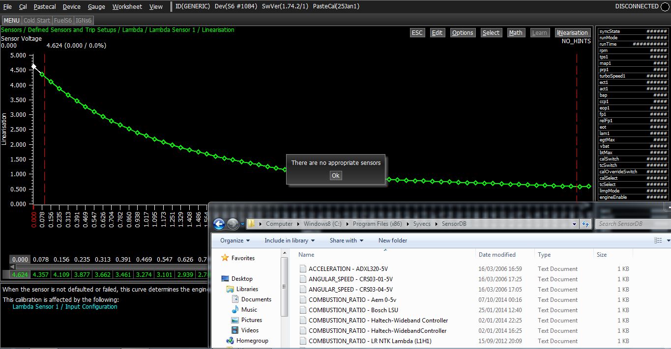

Hi all,
I went to copy a lambda sensor scaling yesterday and realised that I can't - when you do N>B>L I get the error:
"There are no appropriate sensors"
Yet in the Program folder there are...
See attached screen shot.
I get the same with LifeCal... any ideas?
Re: SCal forgetting sensor library
I recall that some SSuite versions have an error in the install structure and look for files in a sub folder...SensorDB\SensorDB. Might be worth checking and adding a copy of the SensorDB folder to a same-named sub-folder.
