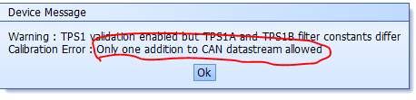

Just wondering if anyone has had this message pop up and what to do if so? Message " Only one addition to CAN datastream allowed" pops up when connecting to SCal and the device is "not in sync" until you choose NONE on the datastream.
S6 with I/O 10 expansion port.
Plex SDM 500 with GPS (not communicating with S6)
Connection to Plex
Connection to Plex
- picture of device message

When running an I/O expander, the CANbus becomes dedicated to the expander. You must have selected some other incoming datastream.
That said, I believe the Plex can co-exist with an I/O expander - but probably only to receive data.

The plex CAN1 connected to the CAN bus 2 on the Expansion box. The CAN1 is used to slave the unit which is working. Not sure if this helps or not. Note with or with out a termination resistor the same message appears so I am guessing the S6 just does not like the custom CAN enable in the datastream. I did contact Plex but just posted this since someone out there might have had a similar issue with a similar set up as me.

And that's the point... when an S6 is connected to an expander, it cannot receive any other information via CAN bus. It's not the fault of the Plex, just the way it is.

Yes, it's also true of the Syvecs/Life Racing GPS units.
The slave protocol dominates the CAN RX function of the ECU, although the ECU can still TX the generic datastream for dash products (albeit it at a non-standard CAN data rate!!).

No reason an expander (or CAN bridge) can't relay info to the S6 in theory, as long as the parameters in question are available as "real" inputs in the S6 I/O assignments.
This is how I get GPS-derived speed to the S6 using RADAR speed as the input assignment with our own expander. Similarly accelerometer data etc.
But GPS latitude and longitude are not available as physical inputs.
And the X10 would need to have software to do this translation: to "listen" to data from the Plex, translate it, and dump it back out on the slave connection.
