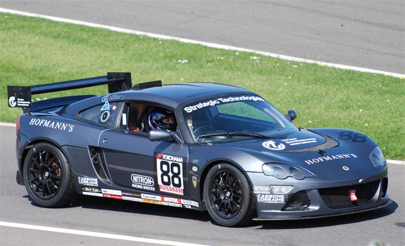

Heading out to qualify at Silverstone, nervous times for all.

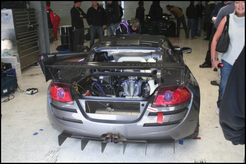

After qualifying 3rd the mood in the garage was upbeat but we knew we'd have our work cut out in the race

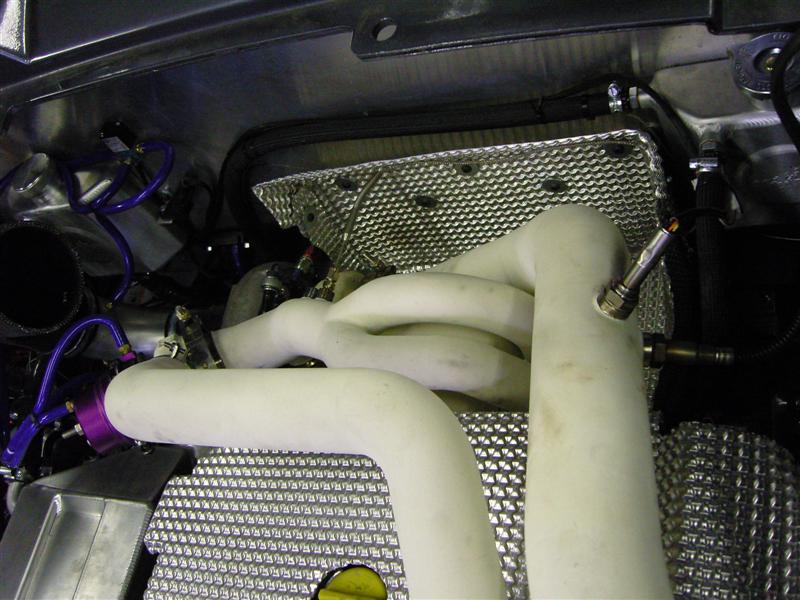

Manifold, Turbo, Wastegate, Exhaust, lambda's and EGT

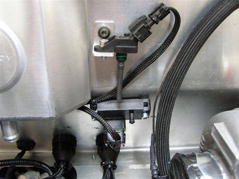

Baro sensor and Map sensor

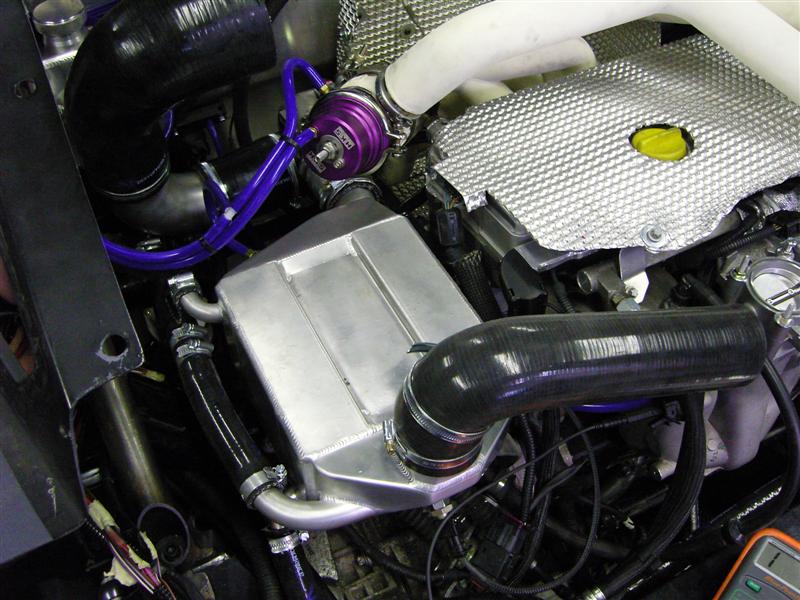

Water/Air intercooler

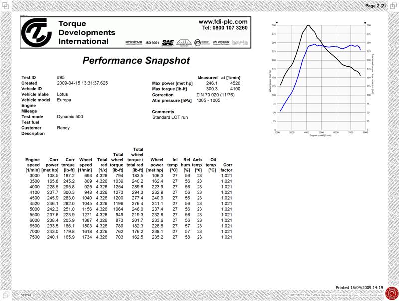

The dyno results, the race series dictate that the ramp rate on the dyno be 500rpm/sec and the class limit is 250 at the hubs. The control of the S6 made maximizing the rules to this extent possible.

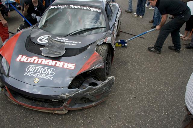

After suffering very heavy damage only a month ago at Brandshatch when our man was "collected" by an out of control Lotus 2-11, the Solaris powered Europa was fully repaired, upgraded and back in the action at Snetterton over the weekend at the annual Lotus Festival round of the Lotus Trophy bouncing back with a commanding win in race-1 followed by a hard fought 2nd in Race-2.
All four corners where completely wrecked after finding the tyres at 70mph+

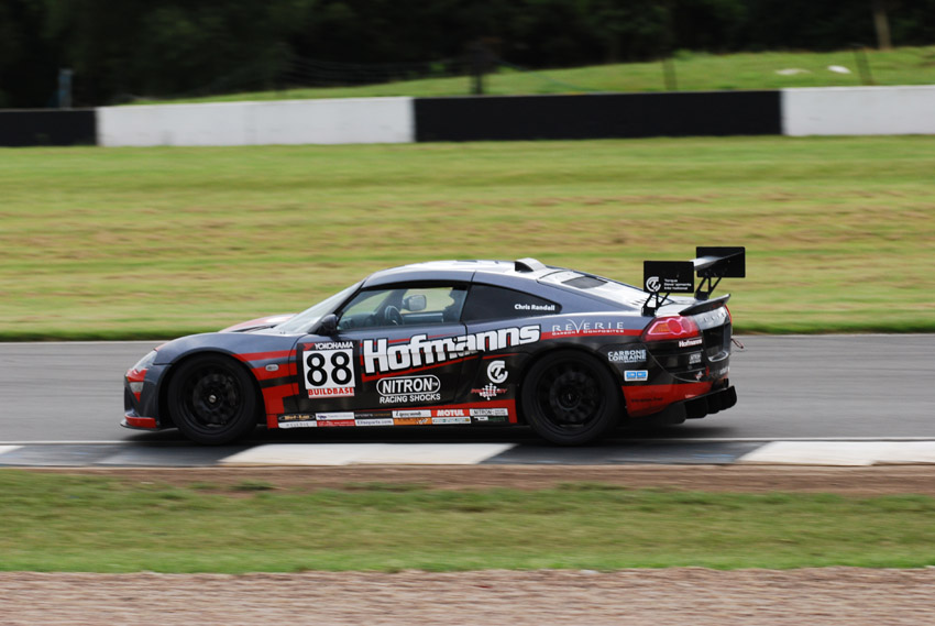

Engine performance is still amazing the driver, the broad range of power meaning that only 4 gear changes where necessary per lap.

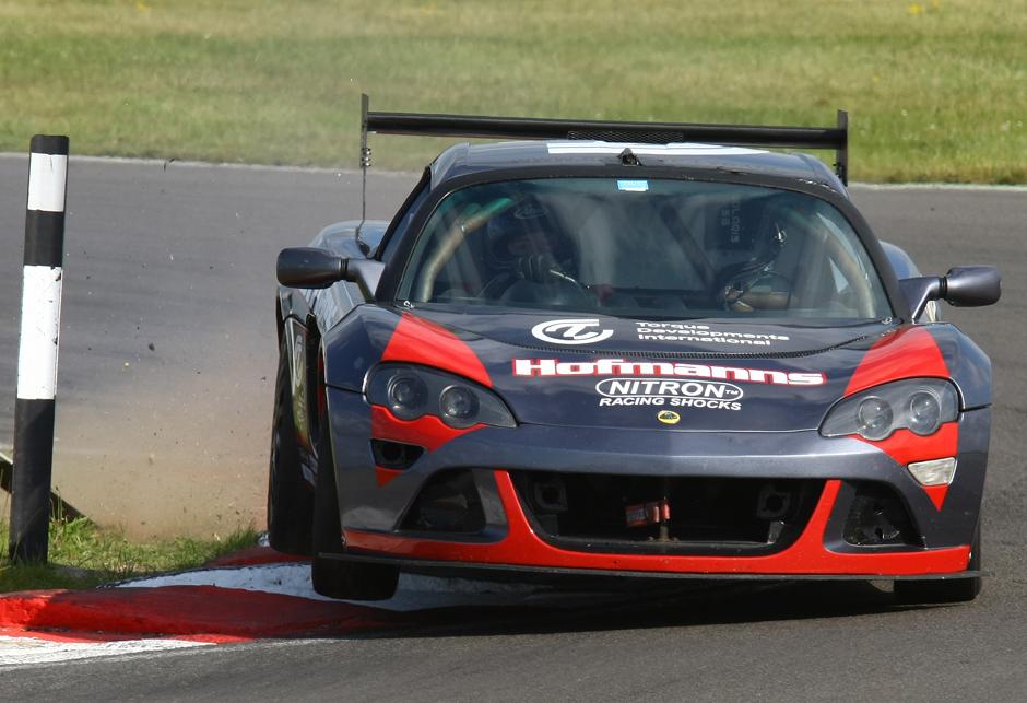

Thought Charlie might like this one,  the Solaris S6 is visible in this shot of Chris pushing on in the Europa at Snett.
