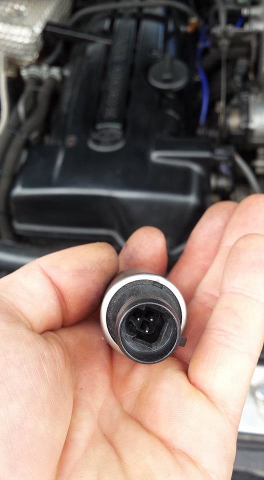

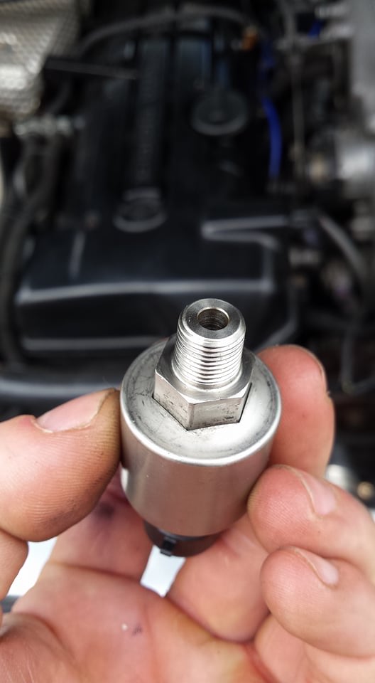

I had an ECU slung into my Toyota Aristo about 3 years ago. Brief spec is 2JZGTE, FBW, Manual Box. Its an S6 Syvecs ECU.
Basically. I had a spare input which I wanted to use for my aircon now its fixed. This was identified as Pin 58.
Went to use it, found its already connected when SCAL says it should be vacant. Trace it and find its connected to my map sensor.. BUT SUPPLYING the power.
So I go into syvecs and find yes, its running off 3volts, and has had the map altered to 'map around' it. Instead of figuring out why it peaks at 3 volts.
So before I move it to the correct 5v rail, I need to know what it is so I can tell the ECU what the correct pressure to voltage table is.
In true fashion, when I got handed a half finished car, I never got any paperwork for it, and 3 years down the line im slowly buttoning it up.
So anyone? Thanks!!
Can anybody identify this MAP sensor?

Re: Can anybody identify this MAP sensor?
Could be anything really, from a generic chinese sensor, to anything else
But where was it getting a 3v supply from ?
Syvecs S6 can't generate a 3V supply so this seems suspicious....
Pin 58 is an AU input, so could float at around mid rail...or 3V if the pullup was turned on perhaps.
Just to be 100% sure, have you counted pins on the right rows? Choosing the wrong row would mean "pin 58" would actually be a 5V output, which is what the power pin of the MAP sensor should be connected to of course. But if its only 3V then somethings not right anyway!
As for what the sensor is, no idea...but they almost always have the same pinout when they have a metripack connector, so you could rig it up on the bench, use a DMM to measure the output volts, and apply pressure with a MityVac to characterise it.
Hi guys.
Yes it's definately pin 58. If I remove the load it rises to 5v. So we decided it drops to 3v because of the pull up resistor.
I'm absolutely livid about it but heyho.
That's not a bad idea, but if I get it a little wrong it might be more problems in the long run, and not knowing the max of the sensor too.
If it's not a common sensor should I just replace and alter the linearisation table to suit?
Thanks guys!!!
Every MAP sensor (of that type) I've come across is 0.5V at 0 bar and 4.5V at full range. If you take measurements at 1 bar and 2 bar, you will very easily work out what the max range is. Or, yes, for the sake of £100 or so, get a new one
