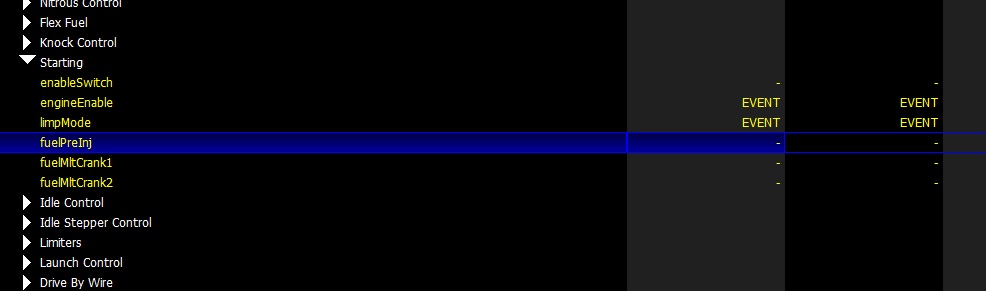

you arent logging limp mode to see when it occurs and what it is saying ?

Cheers - and no I'm not and I probably should be (is that revLimitLimp?)
The only Engine Trip i have currently enabled is the Lean-on-Load Engine Trip - the logbook is indicating that was the limp reason.

It's actually in a rather odd place now that I look at it lol
Or to find it....Config, Goto Logging item and search for limpmode
But increase the time for a trip to activate to around 1000ms. 400ms could muck up misfires, traction loss or other irrelevant events that arent really lean on load.
I've my trip set at 12.1AFR on boost etc and never once has this been tripped when it shouldnt, even when targeting 11.8
