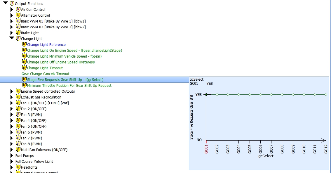

hello all, just wondering how i would set up a "auto up shift" strategy with my s8 with full gear control. i have had a look in scal, but cant find it anywhere.
Cheers, Dave.
Re: auto upshift
Pretty simple see attached pic

champ!! :D figured it would be in there somewhere.
i have to start thinking a little more broadly when it comes to this stuff :?
